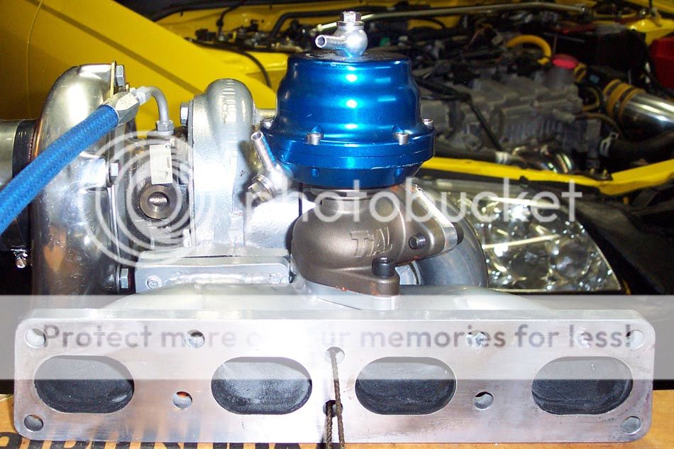

azeli73 said:
This clear enough?
Not really, for what I'm looking for, but nice pic anyway! You got my interest on something else though. What is the blue fitting for on the front of your turbo housing? Are you running coolant through it? I haven't seen any mention of doing this in any of the install threads.
And back to topic, if anyone has a closer pic of the vacuum block installation...?
I thought that was clear enough to figure out where to put the vacuum block.
Yes i tapped the coolant. It's there! Why not use it! The return line is going into the thermostat housing.

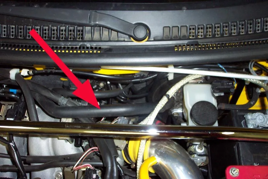

Just take a razor and slice the line you see below and install the block. Then you can run all your lines. (thumb)
So this is it here...?
