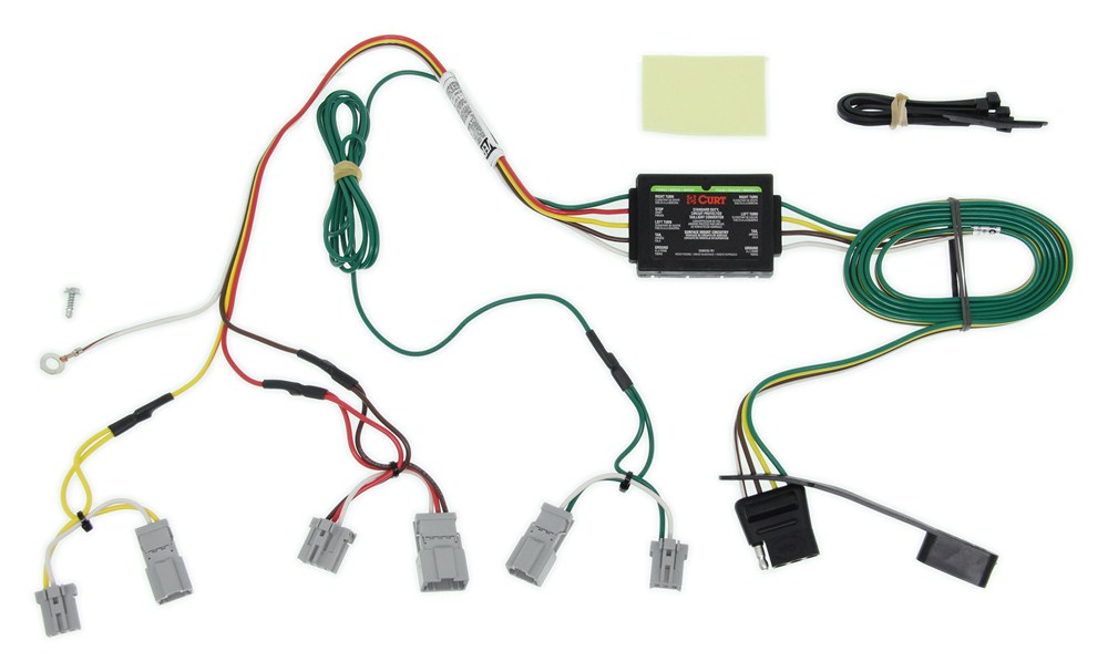

I'm using the Curt trailer wiring kit that simply connects onto existing wiring and doesn't have the full run to battery for power. I know..I probably should've gone with the other kit. Maybe another day.
I noticed this eTrailer warning about mixing LEDs and incandescence.
"Incandescent lights draw much more amperage than LEDs do, and if they pull that current through the LED fixtures, the LEDs could burn up. "
If I converted my rear tail/brake and turn to LED would I then need to convert the incandescents on my trailer to LED as well?
Well most LED's require less current than incandescent. The source can only supply X amount of current and voltage for each light. Your best bet is to contact the maker/supplier of the trailer light set up and whoever provided you your taillight LED's. VLED I'm assuming?
If anything, they'll tell you to whip out a multimeter and start measuring according to their specs.
Will do. I actually haven't ordered anything yet for the rear.
If you plan on changing the rear with LEDs, I think you will be fine. The "risk" is if both your regular taillights and the trailer lights are incandescent. That combo could draw too much current for existing wiring and fuse. I think that warning is probably for cars that come with LEDs from the factory. It's possible that their wiring and fuses aren't going to be sized correctly, if you use a trailer with incandescents.

I have run the numbers but even with incandescents I will still be safe on trailer I intend to pull.
I have another trailer with twice the lights that likely wouldn't work though.
I just want to give myself a margin of error.
