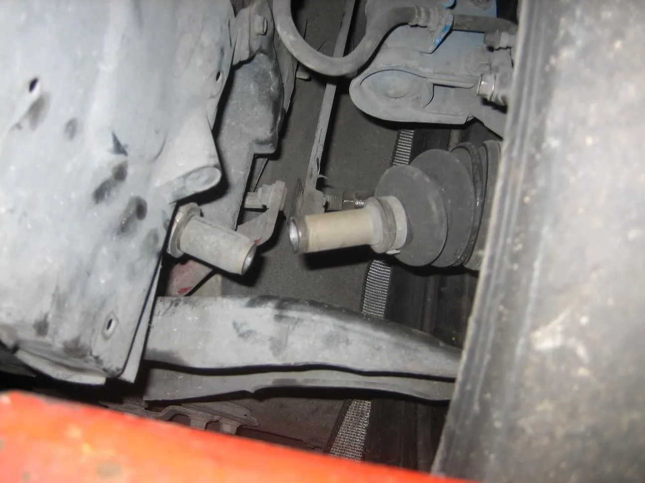

Now we must discuss the self destruction of the axles... Alfredo?
LOL...yeah it popped on the steel bar itself. Literally twisted in two. I have a really good pic but am at school right now. Ill post it when I get home. You can hear it snap if you listen for it on the video I posted.

On the post count that's f'kin weird! The spline is the end on the shaft that goes into the tranny with the snap ring on it. I would assume that's the next weak point past the cv joint.

To answer Shane02pro5 question, the axle broke in the center section between the 2 rubber bootings (I am no mechanic). Alfredo will post the pics of this.

That is very weird! I'm needing to get a new driver side axle since my cv joint has been popping for quite a while. I was planning on upgrading to MSP at least, the cv joint is a bit beefier I believe. I thought that would be the common breaking point!
The MSP axles are identical except for the 24mm shafts instead of 22mm. For the price, the DSS ones are a much better idea.
