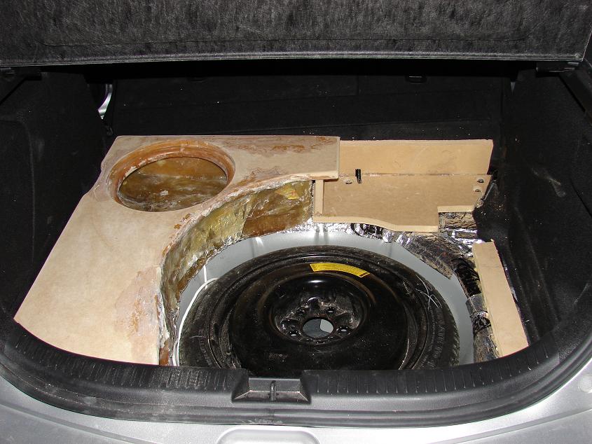

This is a mock-up of how it was created, sorta. I kinda had my hands full of resin and fiberglass shards, so the camera stayed away for most of it...

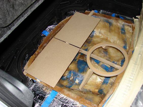

Just so you can see my failures...Here was plan A. Well parts of it. Essentially this was to sink in under the factory spare cover, but I changed my mind as to which sub I wanted to use (didn't want to use a slim-line sub after all) and I ended up trashing this expensive boo-boo. It was perfect for a slim 12" Pioneer, Kenwood, or Tangband sub (4" or less thickness), but all those subs did poorly in testing for a deep response. My final solution was to tub the spare tire well as you can see in the previous photo(s)
