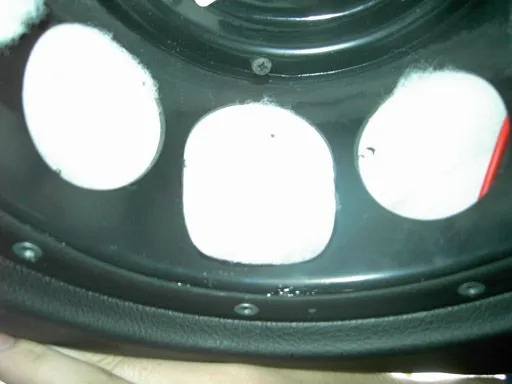

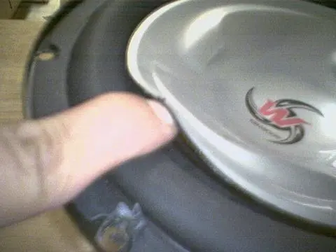

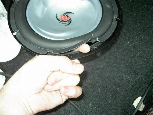

ok got my sub in. first the install...
very straight forward. take out old sub, test fit new sub, i put it in so that the label is right to left withe the left and right of trunk so this way i can see where the clips hit. then i saw the scrapings and i used the dremel to make way for the clips as h-town mentioned (thanks a million BTW), and its a plastic casing inside so use the grinding barells on ur dremel its real easy, took 5 mins. then i clipped the connectors off the stock wires cause i only had the spring terminals. screwed it in with stock screws (supplied wood screws wont work, we have machine screws). and VOILA. my gain is at 3.0 from factory, i dont know if thats too high but it sounds fine. the pics are below, the black foam on the back of the sub are the supplied gaskets which are necessasary, the other pic is the hole i cut so you can see, and the last is the stock kenwood with my finger through it. oh yea and i removed the 6x9 plates for better sound throughput.
as for a sound review. im surprised at these 8" subs. i listened to techno, hiphop (jedi mind tricks. woot, and moulon rouge (lady marmalade) and overall its a nice damn sub, i havent adjusted my system much but i got it on bass 0, NF 0-1, and NF Filter 80Hz. it sounds really good for an 8" sub. , it was 65 well spent.

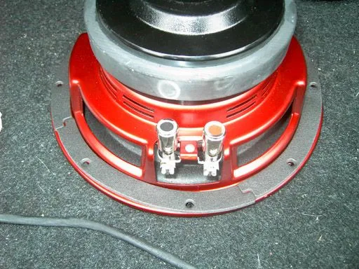

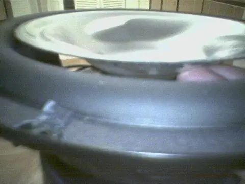

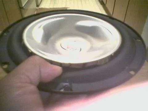

Woohoo!!! (dance) Glad you like the new sub. By the way your Kenwood sub came apart alot differently than mine.(scratch) Here are some pics of mine:
oh wow yea thats an issue lol, but i guess since my outside came off there wasnt any tension to rip the inside. maybe they fixed the issue on the cone but forgot about the outside haha. its funny, the part around all my screws just ripped past them, part of it might be that they use them star things to keep screws in and if really tight it might have ripped the paper surround that came loose. thats my theory on mine lol
