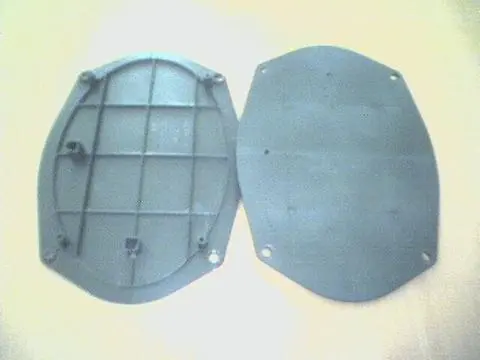

Be sure to put some double sided stick tape on the rear license plate, if you haven't already done so. Your gonna need to. Also make sure to use the supplied foam gaskets on the mounting surface. It makes a much better seal than without it, trust me, I tried it both ways. Sub box is almost completely airtight. I did the ole trick of pushing in the sub and seeing if it comes back out slowly and it did come out pretty slowly. Also if you haven't already done so, you might think about removing the plastic 6x9 plates that cover the factory openings in the rear dash. It increases the bass output with the rear seatbacks in the upright position. Here's a pic of what they look like:

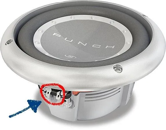

Also forgot to mention that all the pictures that I've seen of the Stage 2 sub, show it with both spring posts and clip style connections. But mine came with only the spring posts. I dunno if this was just specific to my sub, or if they've deleted the use of the clip style connections because of clearance issues. But you can either do what I did and solder two wires to the factory connectors or just cut the connectors and remove some of the insulation to expose the bare wires. I soldered two wires because I've never liked the idea of cutting the factory wiring.

Yeah it's real simple. I just edited that post that you just replied to and added a pic of the plastic 6x9 plates.
for the plates do i remove the sub/amp rack, or remove the speaker grills inside the car?
Pull down both rear seatbacks and you will see 5 plastic doohickeys holding the rear dash. They are made of two pieces. Pull the center part out with your nail and then the whole little doohickey comes out. Do this to all five. Then all you need to do is grab the rear dash from where the doohickeys go through it and push up on the rear dash. It is also held down with some clips hidden on the other side of the dash, so some "friendly persuasion" might be needed in order to get these clips to let go. Be very careful not to pull up on the rear dash too hard as you may end up scratching your rear tint(if you have tint) when the rear dash finally does come loose. Once its loose, just lift the rear dash up and towards you and set it down between you and the where the rear dash was before. You will then easily see the plates and all you need is a phillips screwdriver to remove the four screws holding each one down. I suggest you screw the screws back down in the factory holes(tightly) as to not lose these screws as they may come in handy if sometime down the line you wish to mount some 6x9's or use the plastic plates to cut some holes for some 6.5" or 5.25" inch speakers/components back there. This way you already have screws that you know will fit properly. The factory connections for the 6x9's are still there and are connected to the plastic plates. You'll need to disconnect these before the plates will come loose. Also I suggest that you tie down these connections as to not have them flapping around and possibly making an annoying rattling sound when you hit a bump or when you turn the bass up. While the rear dash is out it might not be a bad idea to stuff some insulation down there to elliminate some of the rattlling between the sub box and vehicle chassis/body and between the vehicle chassis/body and the rear dash. Better to do it right the first time, cause I guarantee if you don't do this, you will have annoying rattles. If any of this is unclear please just ask me to clarify, it's absloutely not a problem. I'm just trying to help. Unfortunately I can't go out to the car right now and take pictures of some of this because my fianc has the car and she's at work.
insulation like dynamat or stuff fiberfill into the 6x9 holes? i never ripped this car apart yet so i havent seen it in person. im sure i can figure it out but i was a lil fuzzy on stuffing what and where :)
Dynamat would be best but you would have to remove the sub box so that you could place the dynamat between the the box and the chassis. I just used this foam that looked like carpet padding. It's like made up of different color pieces of foam glued together. I'm pretty sure you've seen this before. It worked for me. Stuff just enough in there so that it creates pressure between the sub and the chassis/body so that they don't rattle against each other. Just keep in mind that if you stuff too much in there you might defeat the purpose of removing the plastic 6x9 plates in the first place. I just pushed down on the sub box through the 6x9 openings in strategic places and listened for what sections would cause the rattling sound to go away and then I placed padding in those areas. I don't know where to find it as I got it from a roll that I found at my parents house that my brother used to use back in the day when he was into car audio. It's a little ghetto, but it works for me and as long as you can't see it, what's the harm. On the top part, just cut a piece that is about the shape of the rear dash and place between the rear dash and the vehicle chassis/body. Then reinstall the rear dash with the five little doohickeys. It's that simple. I don't think polyfill would work since it's got to create pressure and polyfill is too soft and fluffy.
