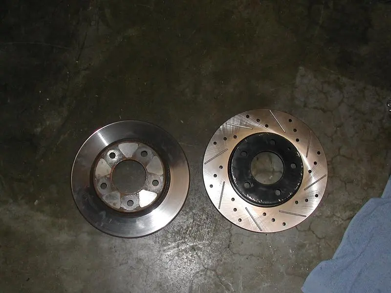

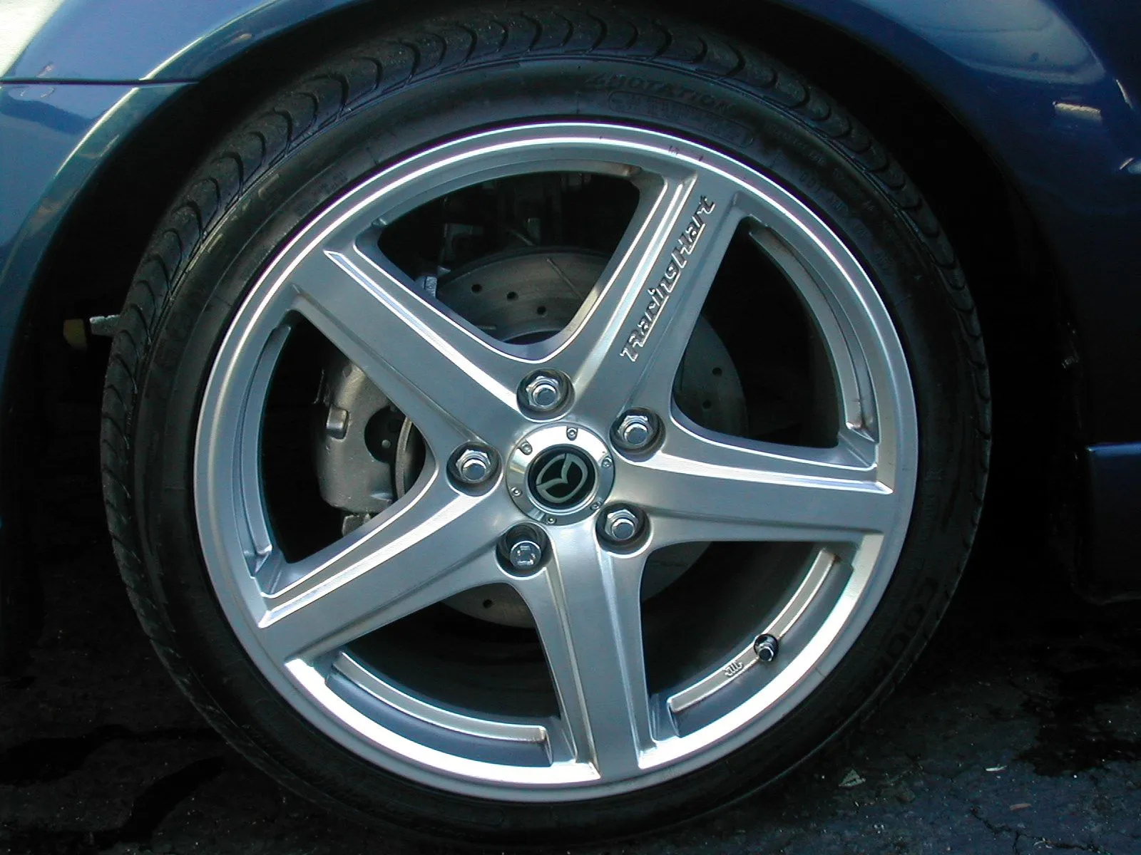

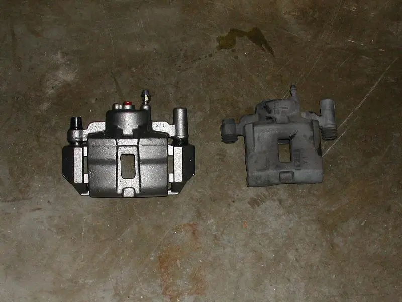

F FC3s Boy Member : 2006 forester XT, 95 eclipse 03 protege5 Jan 27, 2005 #3 yea the MSP kit will bolt on, it runs $350 and i will have some more in next week Attachments P5 big brake 001-1.webp 41.8 KB · Views: 186 P5 big brake 002-1.webp 39.3 KB · Views: 155 P5 big brake 006-1.webp 40.9 KB · Views: 156 P5 big brake 008.webp 141.1 KB · Views: 161
