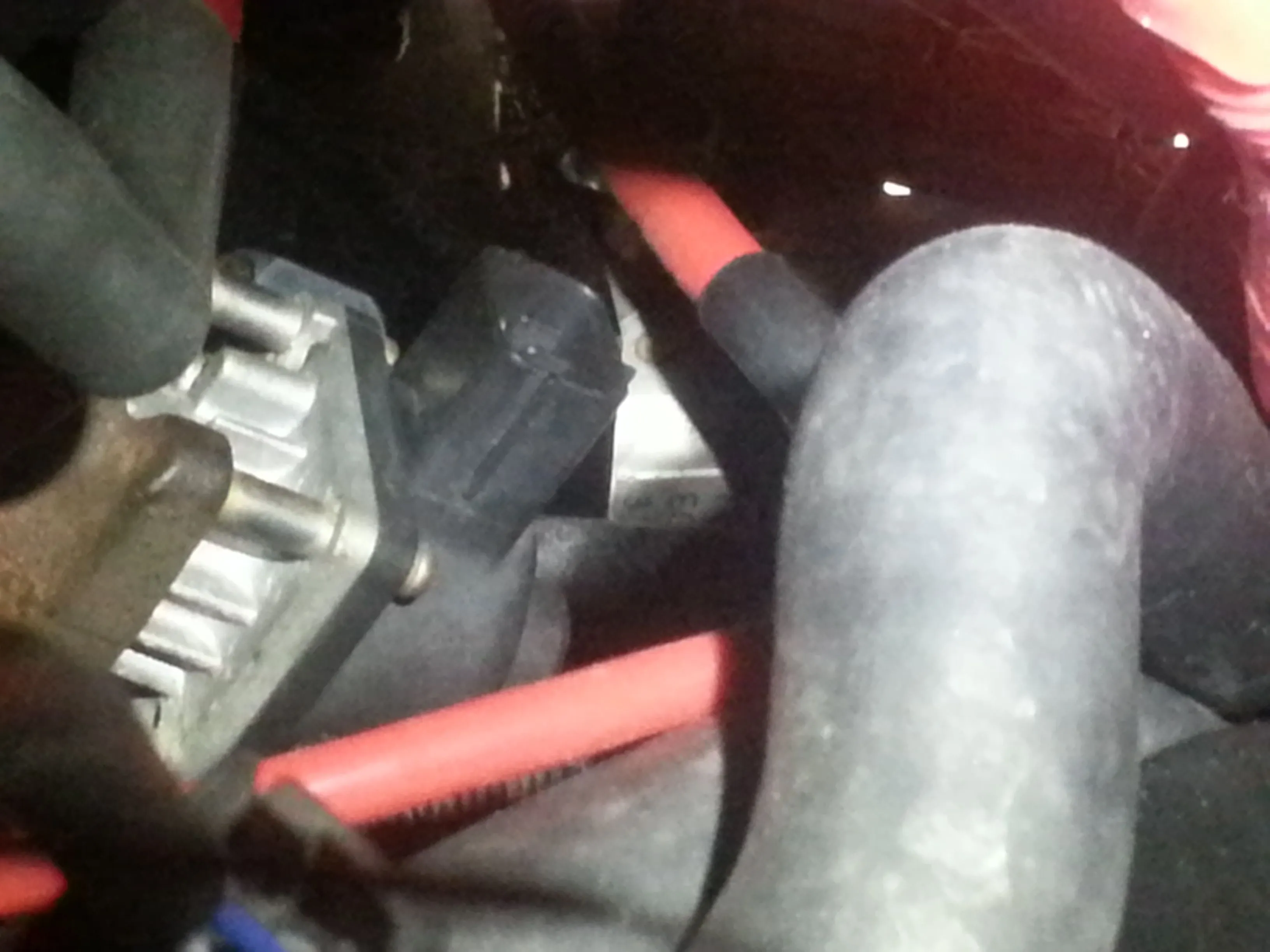

in the meantime, anyone know if this should be connected?! its on the throttle body, underneath.. rofl.. i dont even think i have a spare plug, thought everything got connected already...

Congrats! The pic you posted is the EGR it has to be plugged in to prevent a CEL. Most stores only have 2 weights for gear oil, Proteges (and most cars) use 75w-90.
