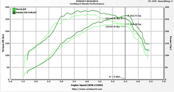

WOW...regardless that the K&n made alittle more ponies..both intakes made 25+ hp over stock according to that dyno. Do you have any other mods at all..anything over 15 hp for a sri is pretty high..regardless wow. Back to the intake question..get what you want..there all wayyy better than stock...the corksport is nice piece..PG makes a good product..K&n is nice..little spendy..but dealerships seem to overlook K&N when it comes to warranty prabs..and the Cobb intake is very nice and good priced..and is perfect if you plan to go with more mods and tune your car...Good Luck.

I'm quite interested in the Corksport combo, but the only dyno info I see on your site is for a combination of mods. Is there one just for the SRI?
Yeah - here's our blog post that talks about the staged gains:
http://www.corksport.com/blog/staged-dyno-results-for-2010-mazdaspeed3/
A quick quote from there to answer your question:
"Stock vs. Power Series Intake System
Our $239 intake system includes our aluminum turbo inlet pipe, billet MAF housing and CorkSport Dry Flow Air Filter. Again, this package includes the turbo inlet pipe -it is the only system on the market that is packaged including the inlet pipe -all others are marketed separately. The torque gains were nearly 20ft lbs increase on average. We also saw large sections of torque gain that were up to 33ft lbs of torque. The horsepower gains were equally impressive with the largest differential being a 36whp gain over the stock numbers. Our system works great, we have put a lot of time into the design and validation testing of it and it generates some serious powerat $6.63 per horse at the wheels.
To echo what Travis at Cobb was saying earlier, the diminishing returns you see in stacking mods on top of each other (the blog post details intake, intake + racepipe, intake + racepipe + downpipe) really speak to the value of a tune. Gains should go up markedly from there with the tuning.
