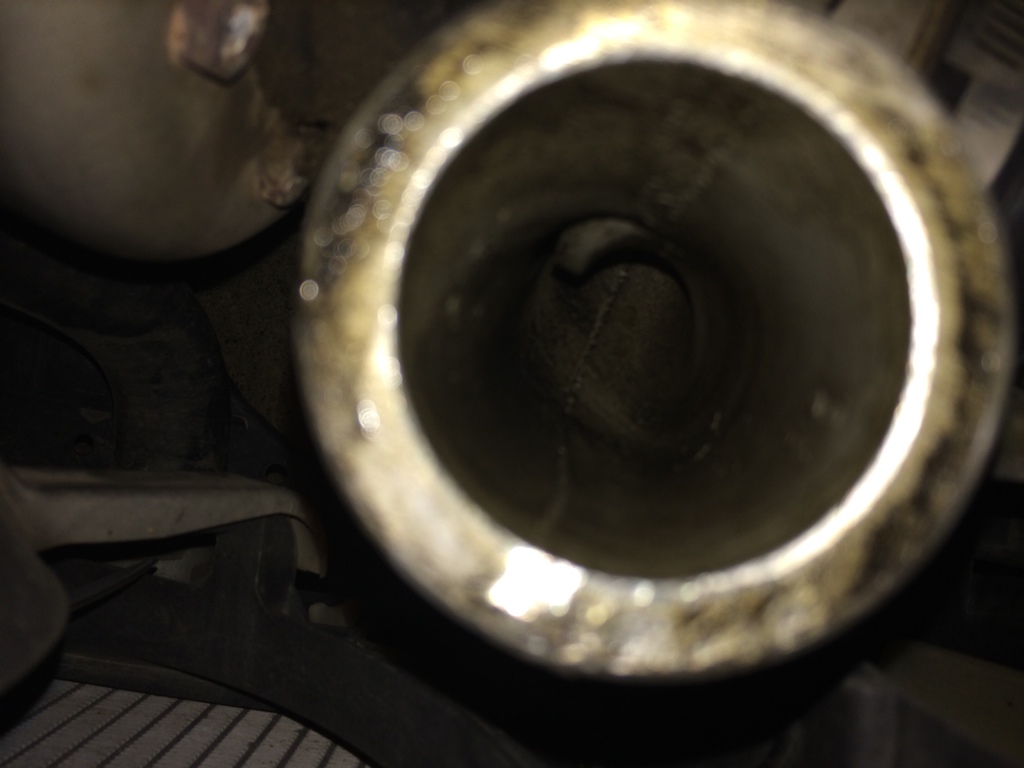

Update.... I have the iridium plugs in right now that are gapped at .042 and the stock ones are $17 a piece. Also this morning my friend notice a small bit of white smoke out of my tail pipe whenever I stepped on it. It smells to me like oil and and a bit of fuel from running rich. I have monitored my coolant and oil levels. I topped off my coolant and oil 3 weeks ago. Today I had to add maybe 3/4 of a quart of oil. The coolant level has maybe gone down a quarter of an inch in the reservoir. Could I have bad turbo seals or could the issue be worse???? Also I have put about a thousand miles on the car in that period of time. Driven it a lot.
Here is the underside of my turbo...

I just replaced them today. No more sputtering. But I'm getting a small cloud of white smoke after letting of the gas in full boost.
