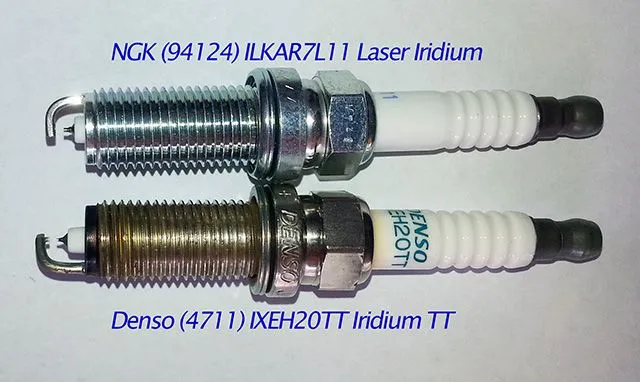

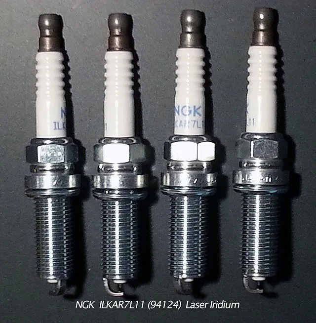

Here are some pics of the 4 new NGKs and a side by side of the Denso plugs I only ran for around 1500 miles. You'll notice that design of the 2 plugs places the spark at every so slightly a different depth in the cylinder. I can only speculate what kind of difference that might make.
attachment.php
attachment.php
attachment.php
attachment.php
