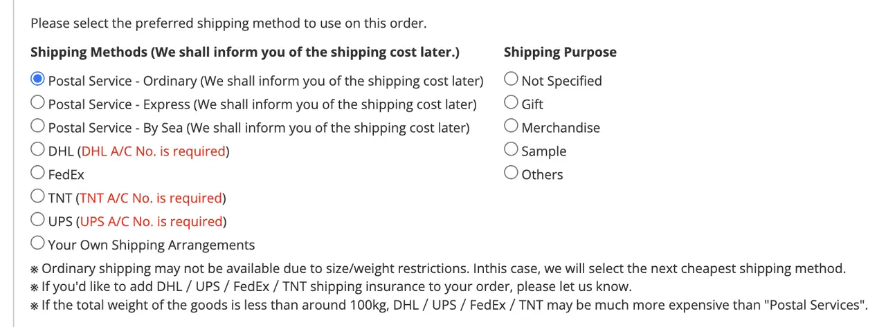

Shipping is usually pretty cheap if you go the Postal Service Ordinary. This can take a couple weeks to receive so don't expect Amazon next day.
