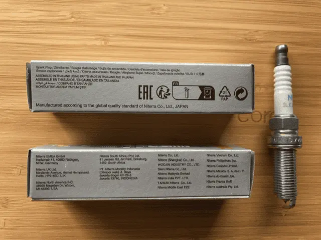

Well, the plugs from NGK.com arrived this morning. ILKAR7L11 # 94124
A) "assembled in Thailand using parts made in Thailand and Japan" as printed on box. Thailand stamped on plug.
B)Sealing washer is captive, won't slide off threads
C)Resistance readings (kohms) 4.92 5.15 4.61 4.78
D) pre-gapped at 0.043"
Sorry, couldn't rotate images , could use some help here

As I posted in a different thread on here, I just purchased these same plugs last week from Amazon. Identical to A, B, C & D above. The resistance readings on mine were all within spec. I went one step further and contacted Niterra North America. After I sent them pics of the plugs and the code number stamped on them, they verified that they were genuine. I got them https://www.amazon.com/dp/ (commissions earned) for $9.72 each plus tax (Amazon Prime, so no shipping cost). Installed them today and my CX-5 runs just fine. This is second set of these NGK plugs and I've never had a single issue with them.

$9.72 (67% off) each for a NGK ILKAR7L11 #94124 is an excellent price. The product info on Amazon page says the Country of Origin is Japan, but yours is made in Thailand?

Correct, the new ones say Thailand. And Niterra assured me they were genuine.
