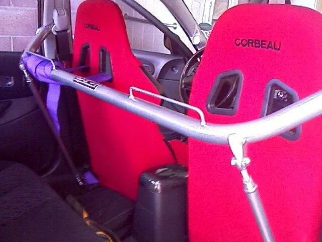

Alright, well thanks to this lasermp5 (http://www.msprotege.com/forum/showthread.php?t=123666908), I took the liberty to buy my friends used Sparco Harness bar for a 02-06? WRX/STI.
Here is a teaser picture below (taken with camera phone).
Please read the linked thread to see the details on install. You will need longer B-Pillar bolts for the top and bottom belts and it is a TIGHT fit.
Best of all, I can use my harness or regular belt now.
Enjoy.

ah! Chris you show of your goodies. but it looks like you cant have any back seat passengers? also how much did you spend? just asking because my friend at Maui did a custom one for around $250. looking good though!
Efren
Mmm got it used for $220. And yes, I can still have people riding in the rear. I have to put my belts back in though haha.
The bar is blocking my blind spot on the left when I turn to look back to change lanes, but nothing serious. It might just be my height haha.

That's when you get E-spec mirrors so you don't have to shoulder check. TheMan has them on his protege. They are curved and give a wider angle.

so there's actually a spot for the vertical support bars to bolt to? or did you have to drill a spot to bolt it in?
No drilling. Just bolt it up. You will need longer bolts though (it was provided with my harness).

Sorry..can you still adjust your seatbelts on the B-pillar? Like up and down?
Nope, sorry. You need to push those all the way down. The bar won't fit if it is not on the lowest setting.
