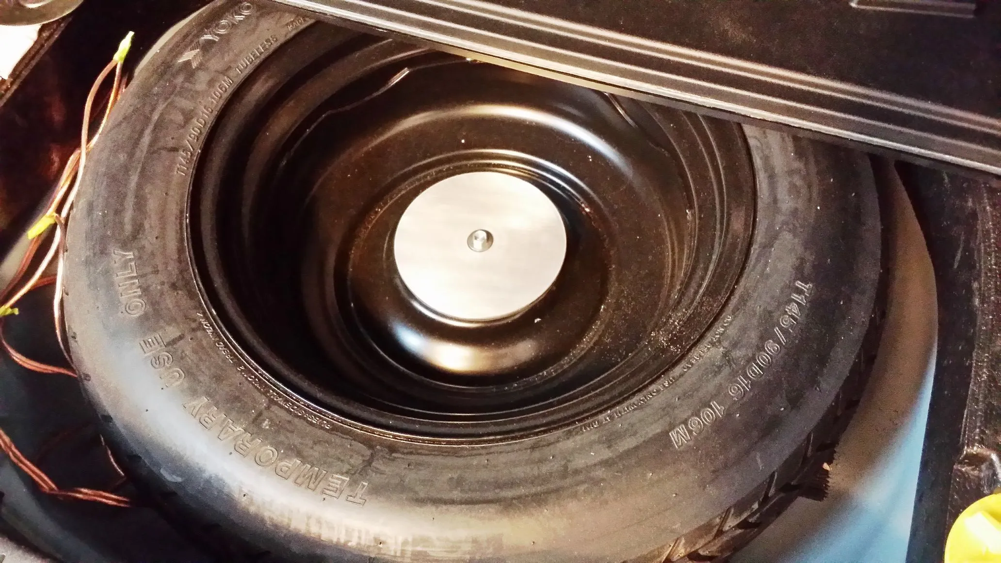

This is, what I have in my 2014 Touring. It is my subwoofer now.
I hate to think what the diff and the TPMS think of it!
