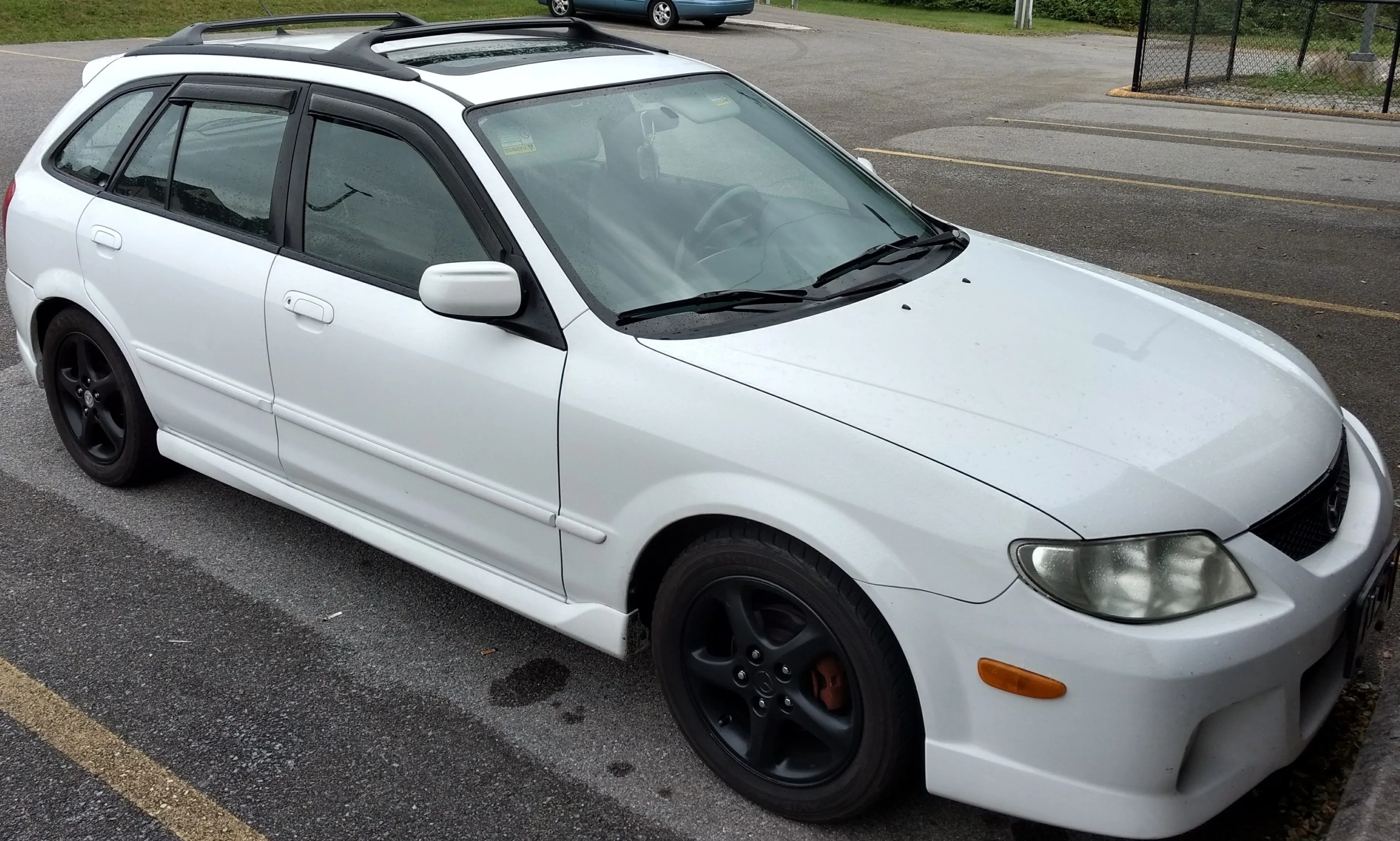

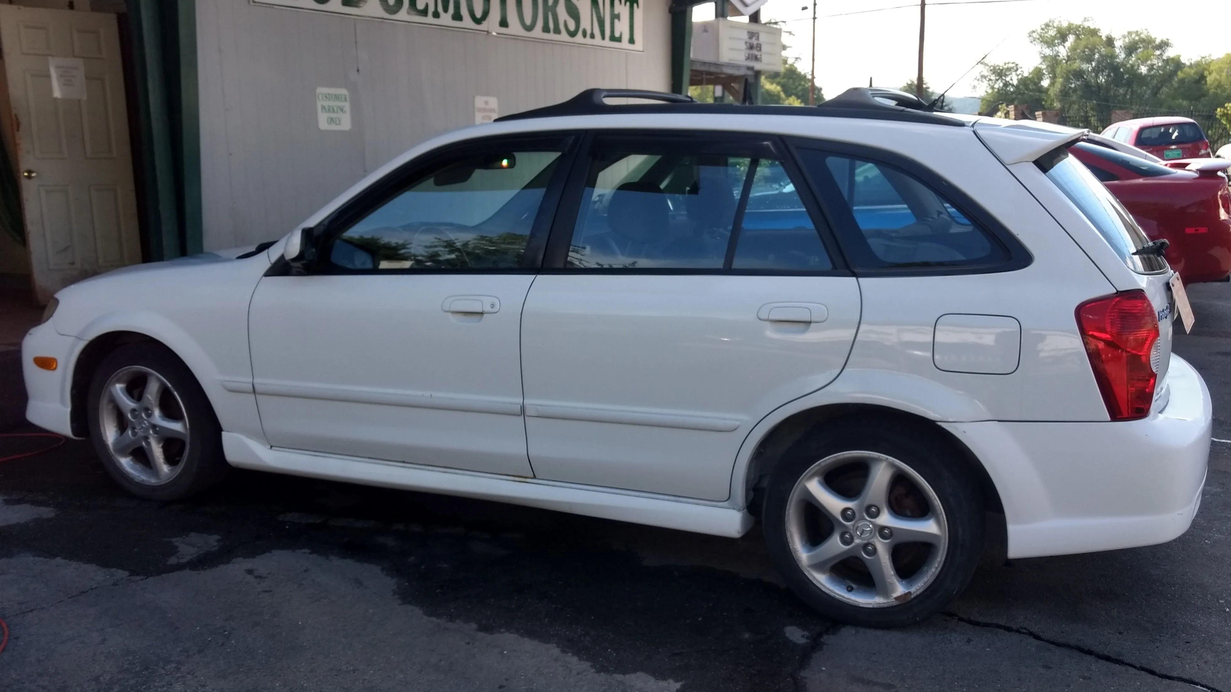

Hey guys, I just bought a p5 a little over a month ago(her name is snowflake), and I've always liked giving my cars a little personal touch and do as much of their maintenance myself as I can(I'm no master mechanic). So I figured it would be fun to get some input and advice from other members, as well as Keep a log of everything I do, and what better way to do so then to start a build thread.
Here she is on the lot.

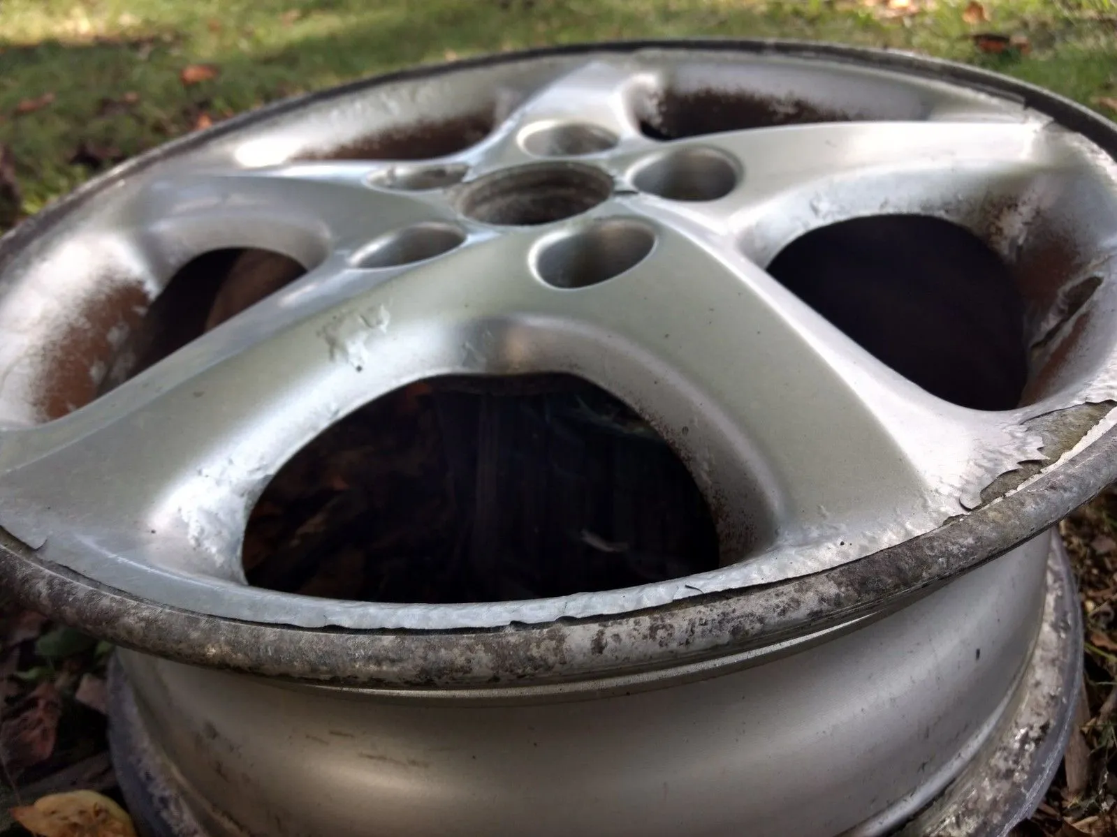

I debated on just getting after markets, but i honestly like the OEM protege wheels. So instead... Lets refinish them.
I started with this...
each wheel was pretty bad but this one was the worst.

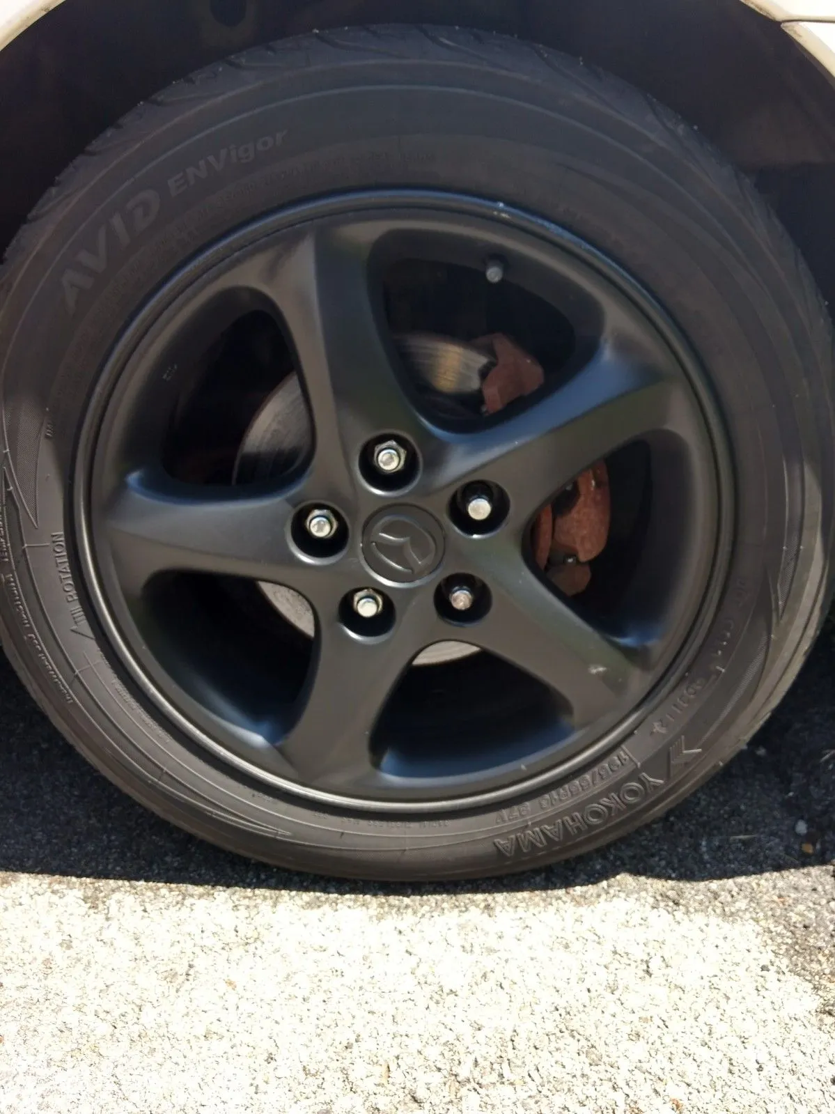

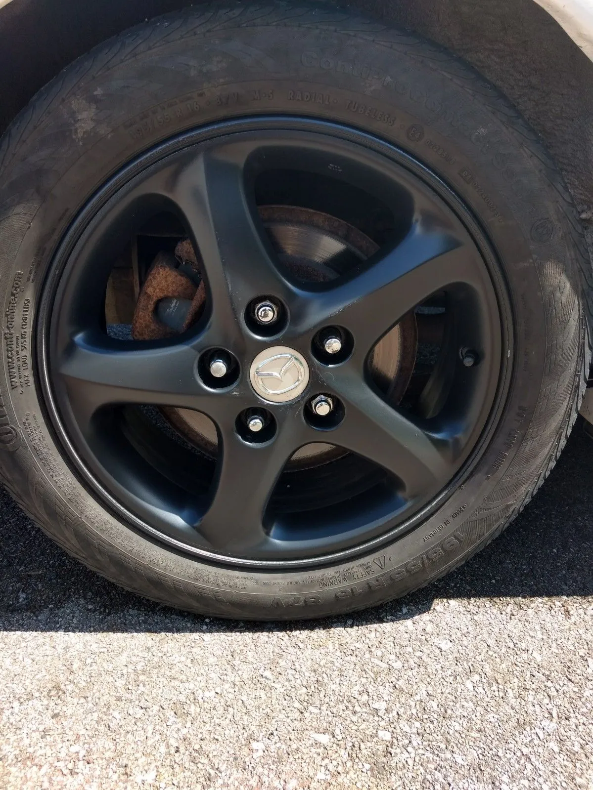

I started with a chemical stripper which mostly just loosened the paint up enough to actually be removed with the wire wheel in a grinder.The grinder works quickly but can't hit the tight corners so i also went to town with my dremmel and a flap disk. After that i used a metal reinforced body filler to fill any major curb rash or pitting. Sand it all up to 600 grit nice and smooth, then cleaned it again and used a self etching primer. Two coats of primer, knock it back with steel wool, clean again, and then the color goes on. Its a black wheel paint by duplicolor. Just 2 coats of color to get a nice dark black, let it dry, and then the matte clear coat. 3 coats all within the same 4 hours to get a nice protective coat and i leave it to dry over night.
Next day i ended up with this:
1 wheel every Saturday for a month, catching up on my youtube and researching more while i wait between coats.
Here she is with her new kicks:
So what do you guys think...
