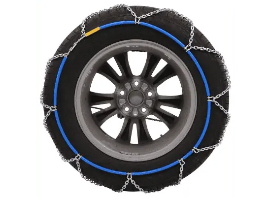

Konig Self-Tensioning Snow Tire Chains for SUVs and Crossover Vehicles - XG12 Pro - Size 247​

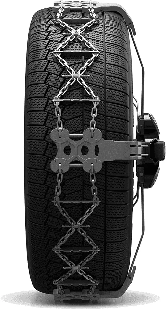

Or, even more expensive . . . requires ZERO clearance.
KÖNIG K-Summit XXL K66 Snow Chains​
StPark, which brand & model chains do you have that fit your 2019 Signature with adequate clearance ? I'm about at a point where I don't care what the cost is as I don't even drive my CX 5 in the snow, the streets in my town are quite steep and either I can't even get started up the hill out of my driveway, or I can't stop going down !
There's at least one that supposed to fit 2019 CX-5 Signature.
Konig Premium Self-Tensioning Snow Tire Chains - Diamond Pattern - D Link - K-Summit XXL - Size K66​
This chain requires ZERO internal clearance, but very expensive over $500, but as you said cost is no issue. https://www.etrailer.com/Tire-Chains/Konig/TH02230K66.html
This chain will fit, need 12mm clearance - at $247, better price.
Currently, I don't have any snow chains for CX-5, looking to buy a used XG-12 #247. If I don't get it on time, I'll take my other car 2015 MDX SH-AWD (have XG-12 Pro #255 chains). I've ordered a set of Cross Climate II M+S tires, should be better than regular All Season M+S tires, we'll see.
Here's the image I found for Konig XG-Pro12 #247 installed, inner clearance. If correctly installed, should be well out of the way from wheel. Inner clearance for strut needs 12mm, hair under 1/2".
Great concept and idea.
Solves the clearance problem.
These look nice but would be worried the plastic(are those gray plates made of plastic?) might break on hard ice or slushy snow melt roads when tire might connect with pavement.
At least, with chains, don't need to worry about that with regular steel chains.
But for someplace with heavy snows and minimum snow removal, and an attentive owner that would remove these at first sign of asphalt, these would be great.
Those chains are made of Manganese Nickel alloy 100%, installed over single lug nut with special torque wrench. Very expensive, no portion of the chains are made of cheapy plastic.
Nice. Saw some of these things were made from composites an plastics now. At least this one didn't cheap. Sounds like a good product.
