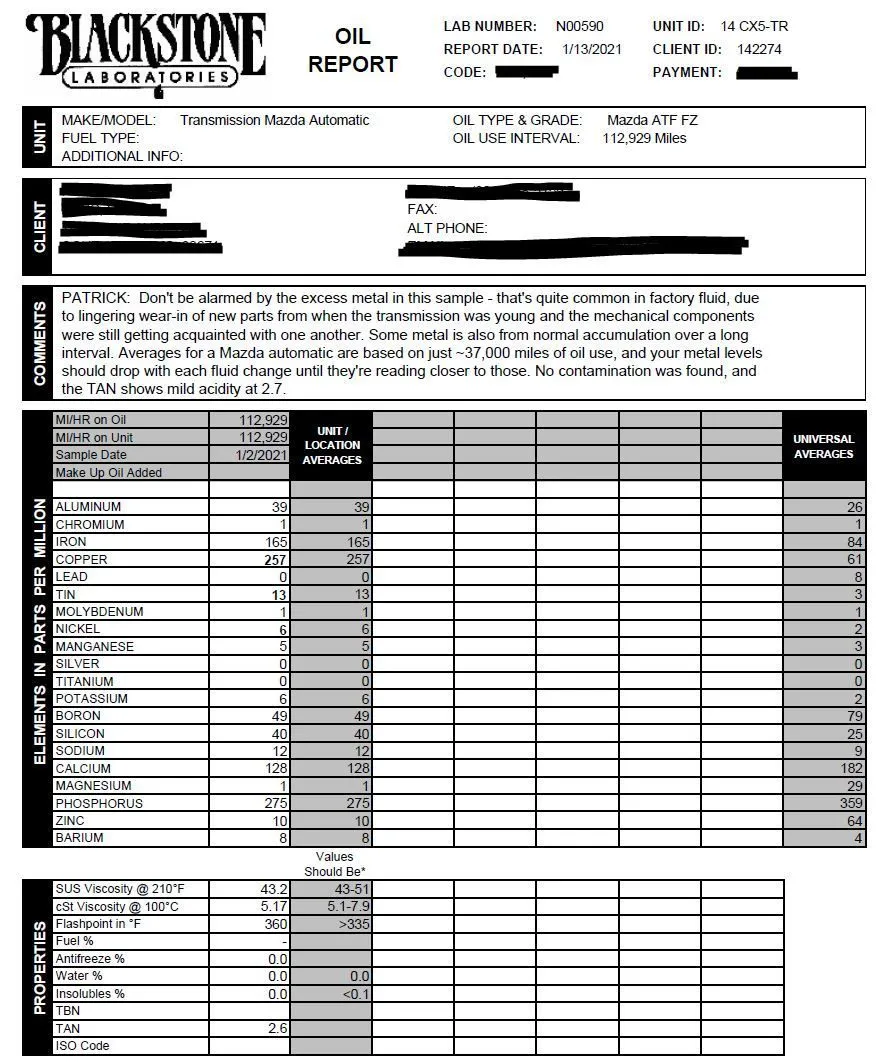

Here’s mine, sampled at around 113,000 miles.
Hello all!
The time is upon us. I have my UOA for my second series of drain and fills. I did 3 drain and fills at ~50k miles back in 2018 with Mazda FZ. Now I'm nearly at 100k miles, I did another 3 drain and fills. Please see the attached for the results on what came out this time.
I'm very happy with the results! I used Aisin ATF-MFZ this time around. If I still have the car at 150k miles, I may follow up with another UOA just to compare the Mazda FZ with Aisin's ATF-MFZ.

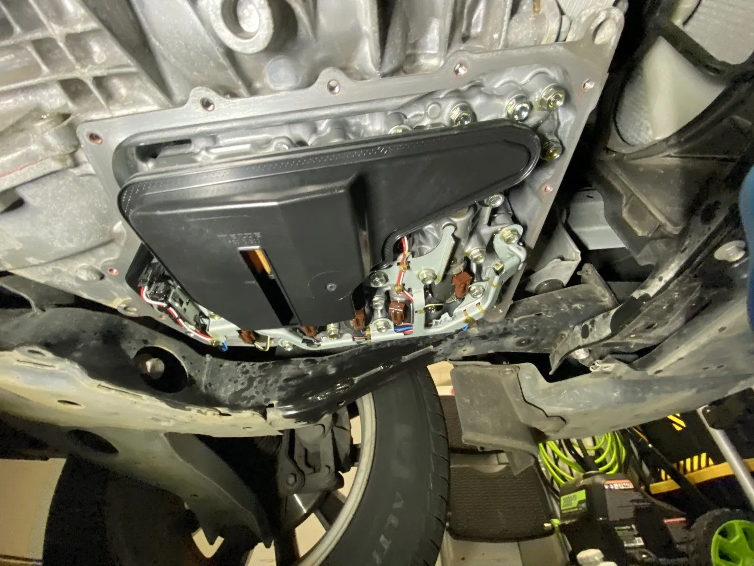

This post from my fluid and filter change job shows the underside of the trans without the pan. Looks pretty clean in there to me, although the filter blocks part of it from view.
The minor or start of the varnish is seen when you use a clean rag and wipe parts like the valve body. This varnish is actually very normal for almost all automatic transmissions that don't get any fluid services. A visit to any transmission service shop is a good learning experience to see internal parts of high milage transmission and most all parts have this varnish on them. This varnish build up is one of the eventual causes of solenoids sticking causing clutch engagement issues which can damage the good service operation of the transmission.
On your next pan drop try wiping the valve body to see the varnish.
That varnish from your rag that you will get you can take the rag place it in clean transmission fluid in a jar and let it soak overnight. Then remove that rag squeeze out the remaining fluid into the jar. and send that sample of oil in to get analyzed.
It is an eye opener to read the results.
My point is this is why it is important to do at least regular oil changes with an automatic transmission.
