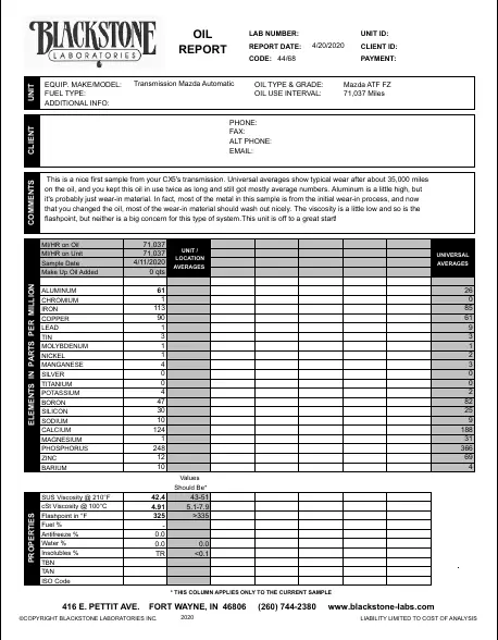

Good find! The analysis on the brand new FZ fluid is great data. Looks like the starting viscosity of the fluid is 44.1 SUS and 5.45 cSt. Comparing our UOA's to Blackstone's 43-51 SUS viscoity range makes it look like slipping below 43 is a big deal. Same scenario for their 5.1-7.9 cSt viscosity range. However, in reality it looks like the SUS viscosity of our used FZ fluid (42.1-42.9) is only a couple units below the starting viscosity of 44.1 after 50-70k miles of use. cST viscosity of our fluid is 4.83-5.08 vs 5.45 new.
For the wear metals, I haven't seen anything on what the acceptable levels would be for specifically the SkyActiv transmission. I just sent an e-mail to Mazda to see if they'd be able to share data or a table with that info. I'll post that later if they respond. In the meantime, I found a generic table from oilanalysis101.com. See the table below. The only wear metal I see creeping up into their "Abnormal" zone is the aluminum in Colorado's sample. The silicon contamination in all of our samples falls into the abnormal category.
Here is another source for reference. Check page 7 of this doc for the "rule of thumb" limits for different components including transmissions. They also state 50 as a limit for aluminum present: http://www.certifiedlabs.com/certified/vContent/4/documents/general/Oil_Analysis_Handbook.pdf
Wouldn't surprise me if a second sample after another +50k miles has lower wear metals as we likely got rid of the break in metals.

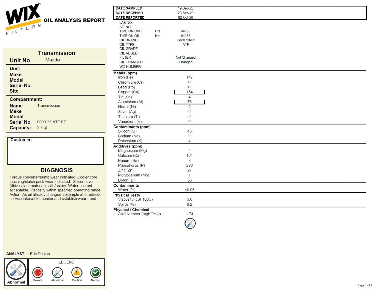

I didn’t plot your data, but I eyeballed it against that graph I made in 2018. The aluminum level in your sample relative to the other 4 samples looks like the aluminum level increases exponentially. The iron and copper levels though look much more linear. Still have to take it with a grain of salt imo with a sample size of below 30. Interesting stuff!
