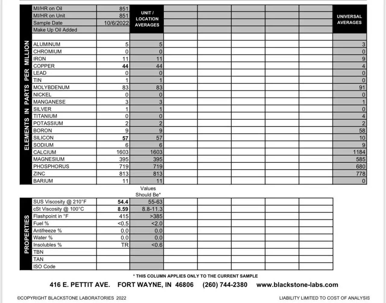

Factory fill oil - Used oil analysis from CX5 2.5T 2022. No idea what Oil Mazda fills in the factory.
Yes the 2.5 NA Mazda oem moly oil is great oil but unfortunately no such good fully syn oil is sold for the 2.5T by Mazda in NA. The oem 5w30 is not good and I think I heard its not even full syn.
The almost non existing Boron in this UOA and the crappy viscosity at such low miles makes me wonder if this factory fill is even full synthetic 5w30. Anyway the oil is gone and next Uoa would be for Amsoil XL 5w30.
No comments from this Blackstone Lab UOA report?
Yeah the OEM Mazda 5W-30 oil sold in the US Mazda dealers is presumably the Castrol GTX which isn’t a full synthetic oil. The parts guy at my Mazda dealer confirmed that too.

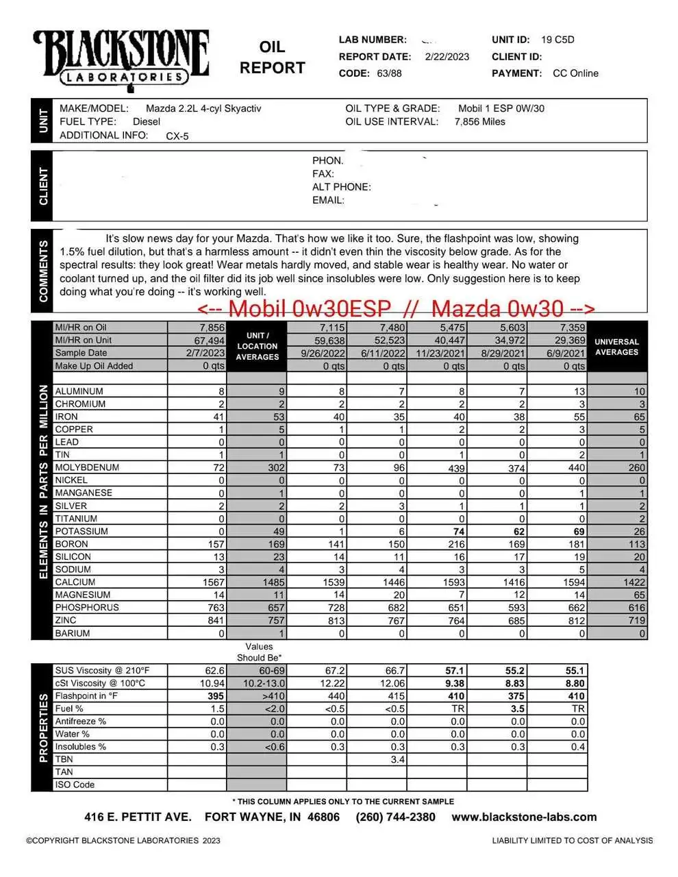

Latest UOA is back on the diesel. Right at 3 years in now with 67500 miles. All is well and cool runnin' 😁
Any particular reason you switched the oil from Mazda genuine SkyActiv-D SAE 0W-30 diesel engine oil to Mobil 1 ESP 0W-30 motor oil? Any differences on oil consumption and fuel economy between the two?
No difference for consumption (none on either) or fuel economy.
Mazda included maintenance for the first 30k miles with the vehicle purchase. I bought a case (12 quarts) of the SkyActiv-D 0w30 diesel engine oil early on just to have on my shelf to insure availability when I needed an included service. There was twice during the first 30k miles that my Mazda dealer didn't have the oil and used mine (replacing my stock later).
Because I saw supply issues with the Mazda oil, I sought out an alternative to have and settled on the Mobil1 0w30 ESP and found it for a similar price to the Mazda oil and bought a case to have on my shelf. After comparing the UOA reports of the Mobil1 and Mazda oil, I'm sticking with the Mobil1. I think it's a better oil, holds viscosity better and the additive package seems to be more robust (evidenced by the higher TBN number).
As a bonus, the Mobil1 0w30 ESP is now available in 5qt jugs for convenience and cost savings (about $35). 👍

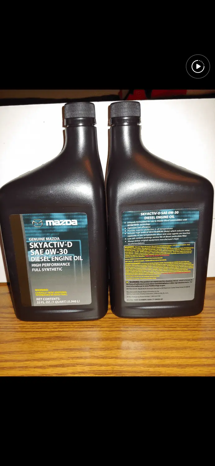

Can you tell if Mazda genuine SkyActiv-D SAE 0W-30 diesel engine oil is also made by Idemitsu like Mazda’s 0W-20 Moly oil?

Can you tell if Mazda genuine SkyActiv-D SAE 0W-30 diesel engine oil is also made by Idemitsu like Mazda’s 0W-20 Moly oil? ...
screenshot_20200803-160650-png.226115
Yep. Idemitsu Lubricants. (Just down the road a couple of hours in Jeffersonville IN).
Incidentally, I've been in the Idemitsu plant a few times. High quality facility. They run a tight ship there. I'd pick my ice cream cone up off the floor and eat it should it fall 😋. A stark contrast to Valvoline and SOPUS (Shell) plants I have visited.
