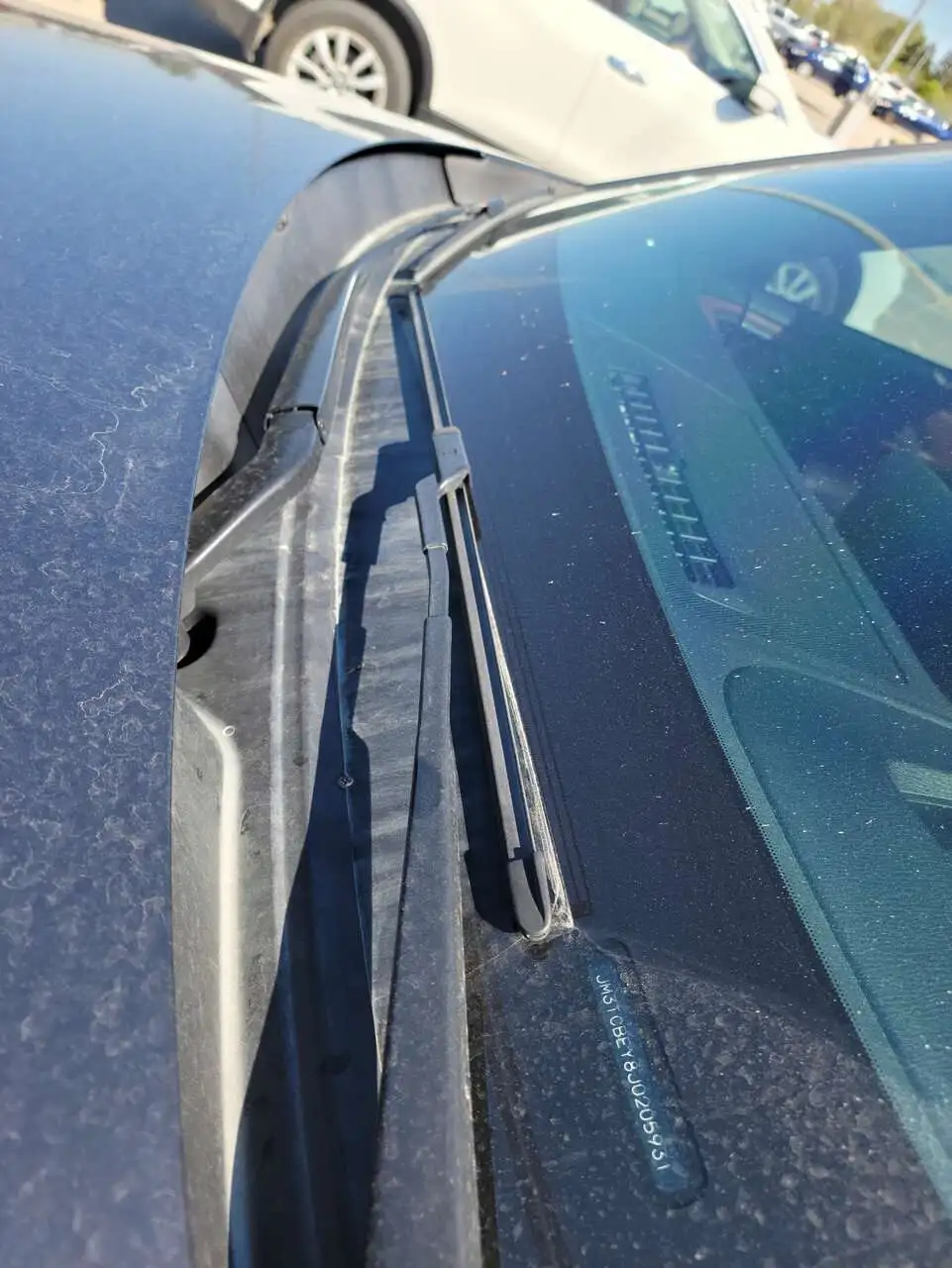

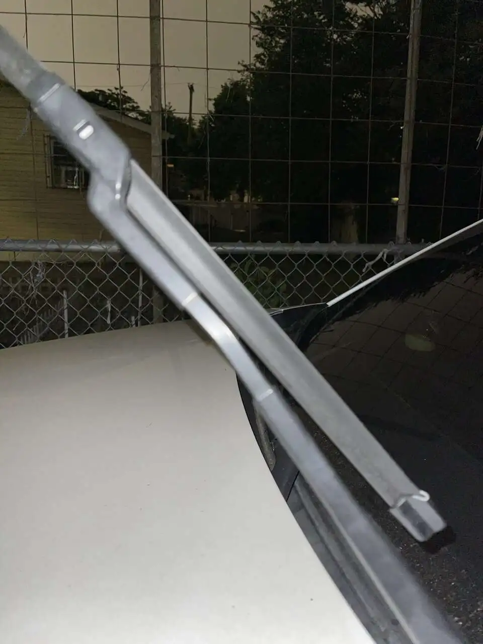

So I have come to the conclusion that both of my wiper arms are bent. I assume this happened when I got my windshield replaced. I confronted my Mazda dealership, but they are not taking ownership of the issue. I’ve attached an image of the driver side bent wiper arm below. If you guys could send me a picture of your wiper arm, so I could compare it to mine, I would appreciate it a lot!

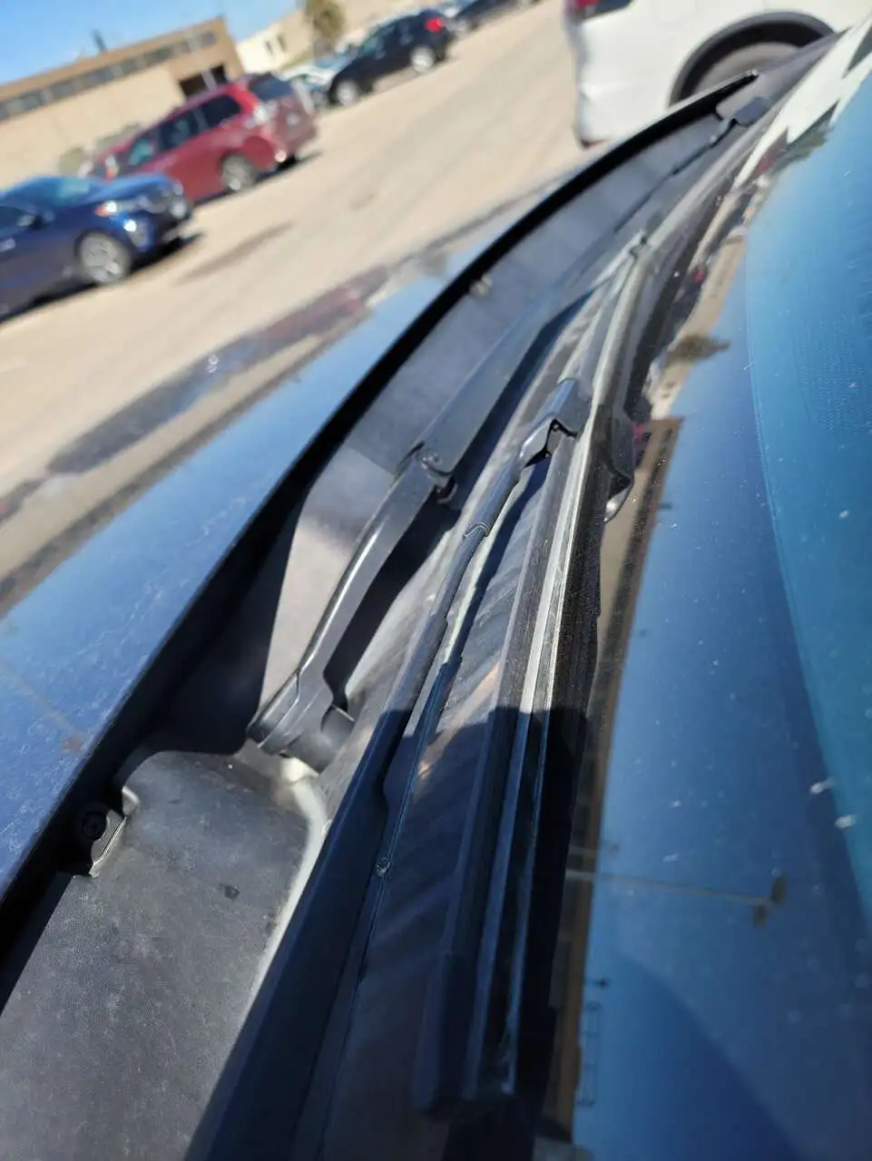

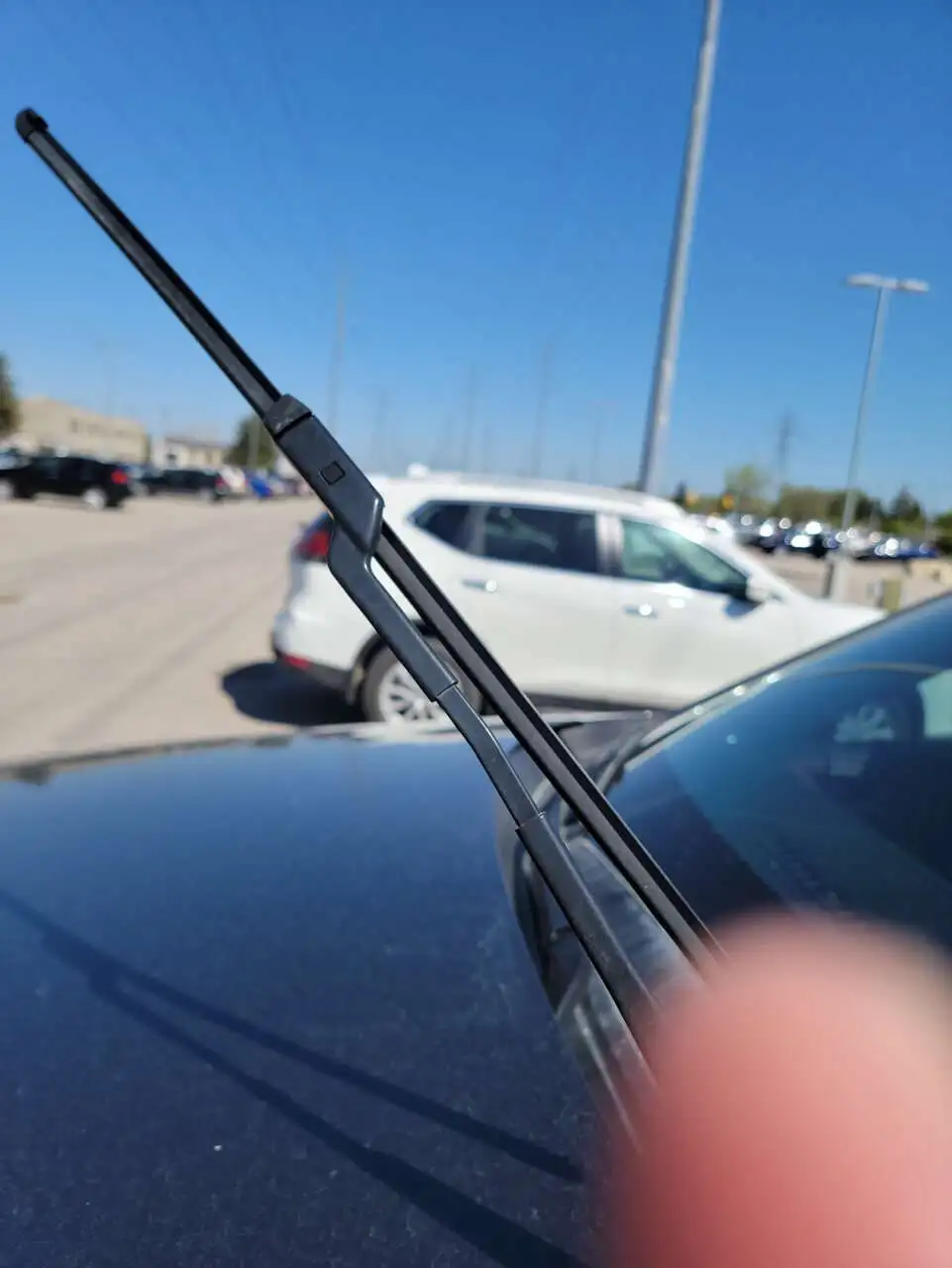

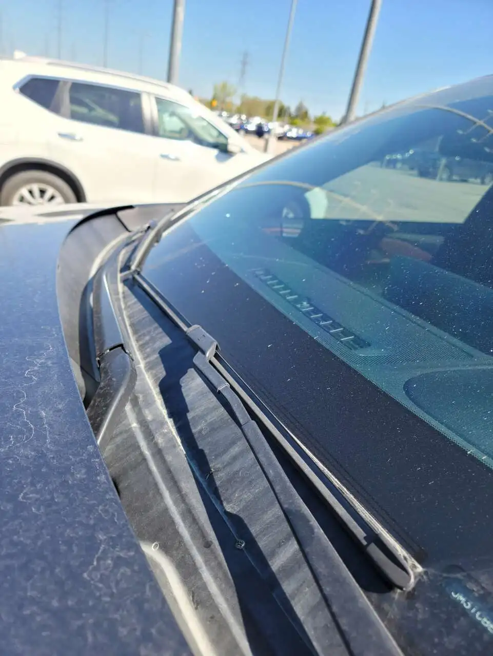

Here are a few pics I took. Hard to see if yours is bent in the pic you posted, but if you lay the wiper flat on the windshield and compare with my pics, you should be able to see if there's a difference. My windshield has never been replaced, and my wiper arms and rubber inserts are all original.
