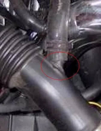

Now, just a little aside to explain why I think this has made such an improvement. I was very horrified to find that on the stock turbo-to-intercooler pipe the bung for the hose that connects to the bpv is not molded into the tube. Instead there is a hole in the main tube and the bung is merely glued on. Well, when I was disconnecting the bpv hose I noticed that this bung was beginning to separate which was probably causing a leak. By the time I had removed the hose, there was a very large gap between the two pieces. So at the very least, if you are not going to install this hose, then check to see if your bvp bung is attached securely onto your turbo-to-ic pipe (especially if you ever pulled the bpv hose off that bung) and glue/seal it if there is a gap.
Check the area circled in red:

Wow, yeah that leak could have been causing your idle problems. I'd be willing to bet that there a more than a few stock pipes out there that are leaking in one way or another. I'd really like to get some hard pipes, but I'm going to hold out for an FMIC.

Yeah, and that shot wasn't even of my car, it was one I had on file of someone else's setup. If I knew whose car that was, I'd PM him and tell him to check that bung. I'll wager that a lot of cars with aftermarket intakes on them are suffering from this problem due to pulling off the bpv hose.

great advice on a problem that I havent really seen addressed on this forum, i need to check mine btw
