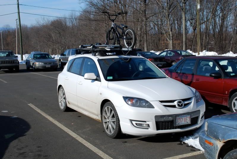

heres my rack:
Old Thule rack that I have had on 3 different Mazdas now...
Could not live without it!!! I carry Mountain Bikes, Skis and a box, awesome rack.

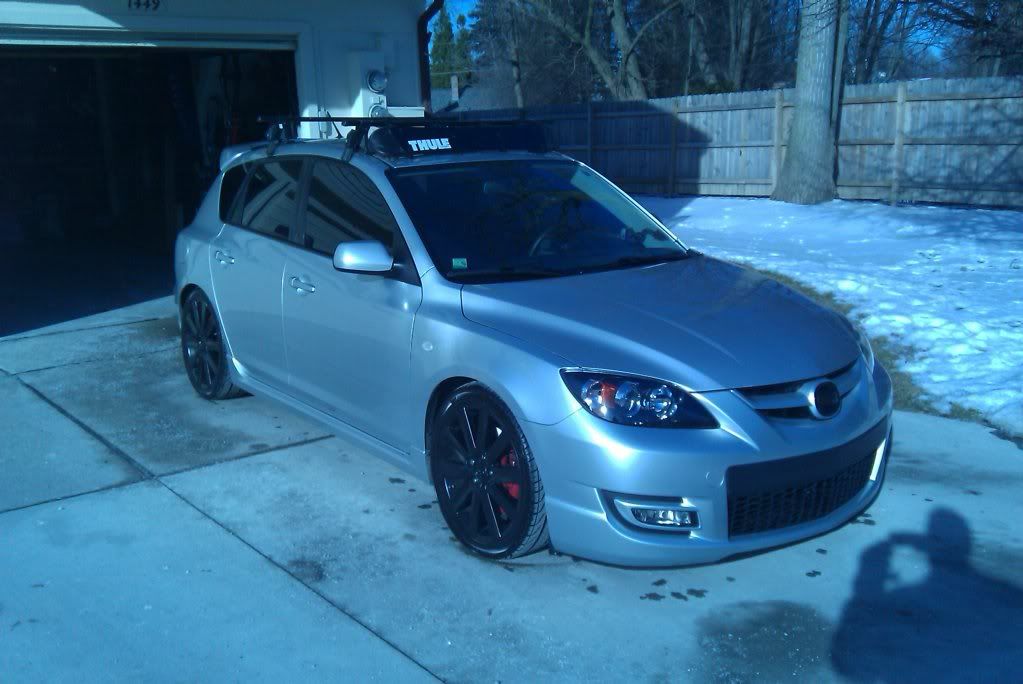

I have the Thule rack with the FIX-POINTS installed.
You have to take off the aluminum rain gutter, mark where the fix points are, then use a dremel and cut a hole in the gutter just big enough for the screw from the Thule piece, to go through the rain gutter and into the car.

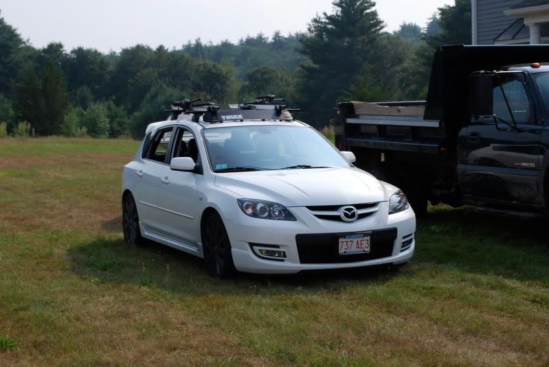

I also have the Thule system with Fixed Points.
I used the slits in the rain gutters (Canadian model).
I mounted a Thule Ascent 1600 on it. Perfect box for a Mazda3/MS3.
It's an amazing system. Very easy to install and the box opens on both sides.
