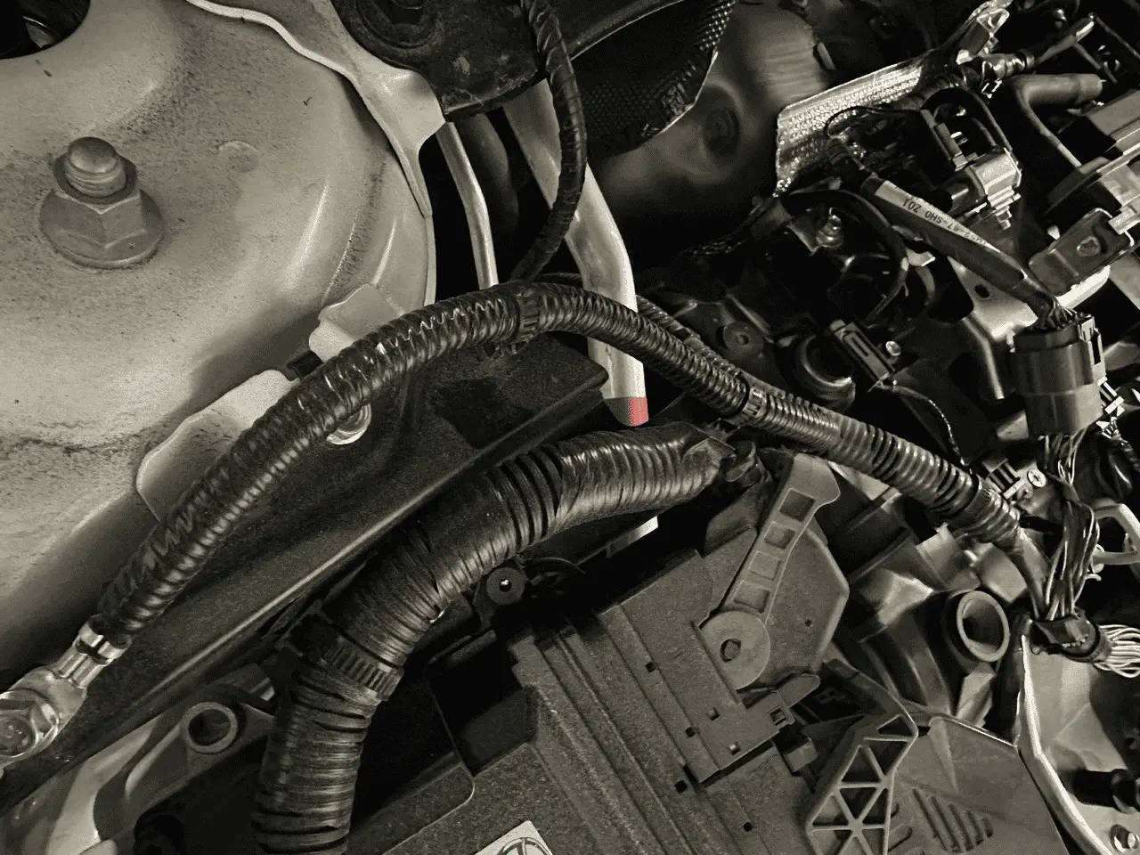

My 2016.5 already has a ground strap running from the right-rear of the head to the right strut tower. It appears to be at least 8 gauge.
I intend to get tuned and dyno this year or next. It would be easy to do an extra pull with a ground connected if I had it preinstalled.
I did wonder about the head vs block connection. I had read somewhere that one may be better than the other but I'm not sure how to choose--do you want the one with less resistance?

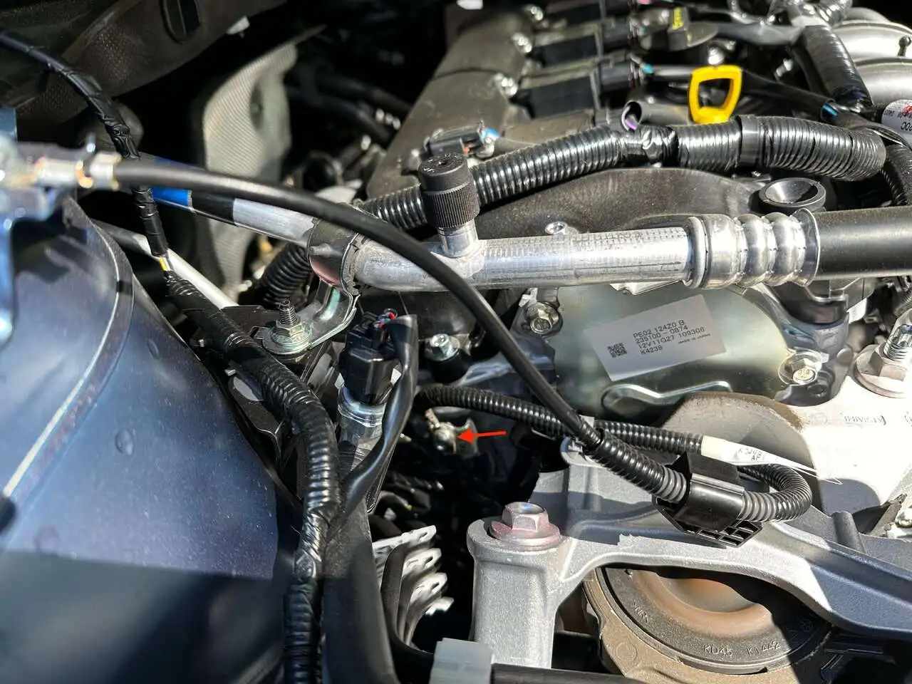

My 2024 also already has a ground strap. It's attached to a bracket with some other smaller wires.

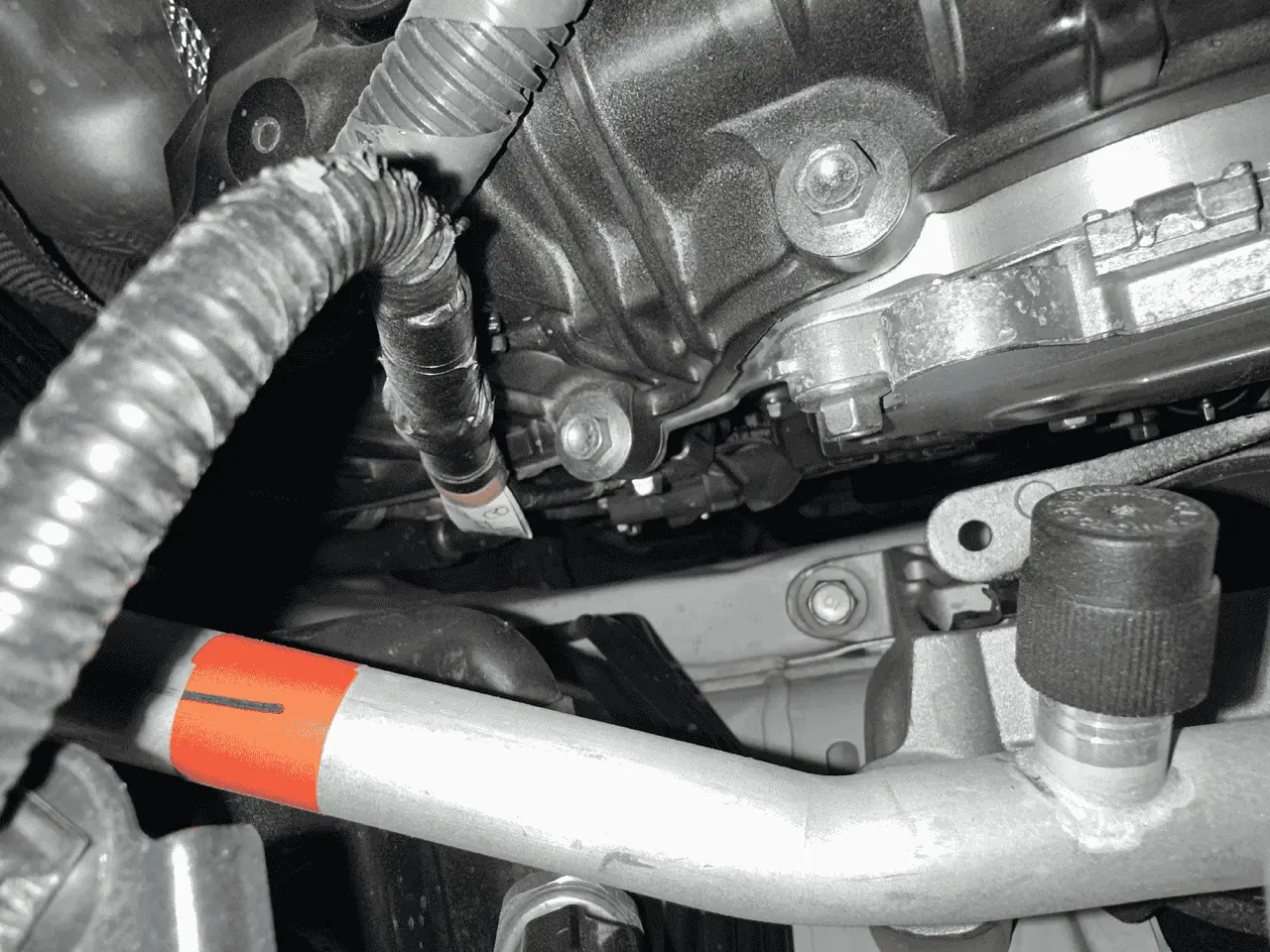

2023 has the same ground strap. I would be surprised if they all don't have it. hard to tell where the lower bracket is attached too but looks like the block. Next time I change oil I will look up from below and see but best I could see is a bracket that appears to go to the block.

Yes in practice. You will want an unpainted/uncoated surface to have a low resistance connection.
the ground strap on mine are definitely going to brackets that are painted/powder coated.
I use a star washer between the ground cable lug and car body. This digs in.
I coat the area with dielectric grease.
