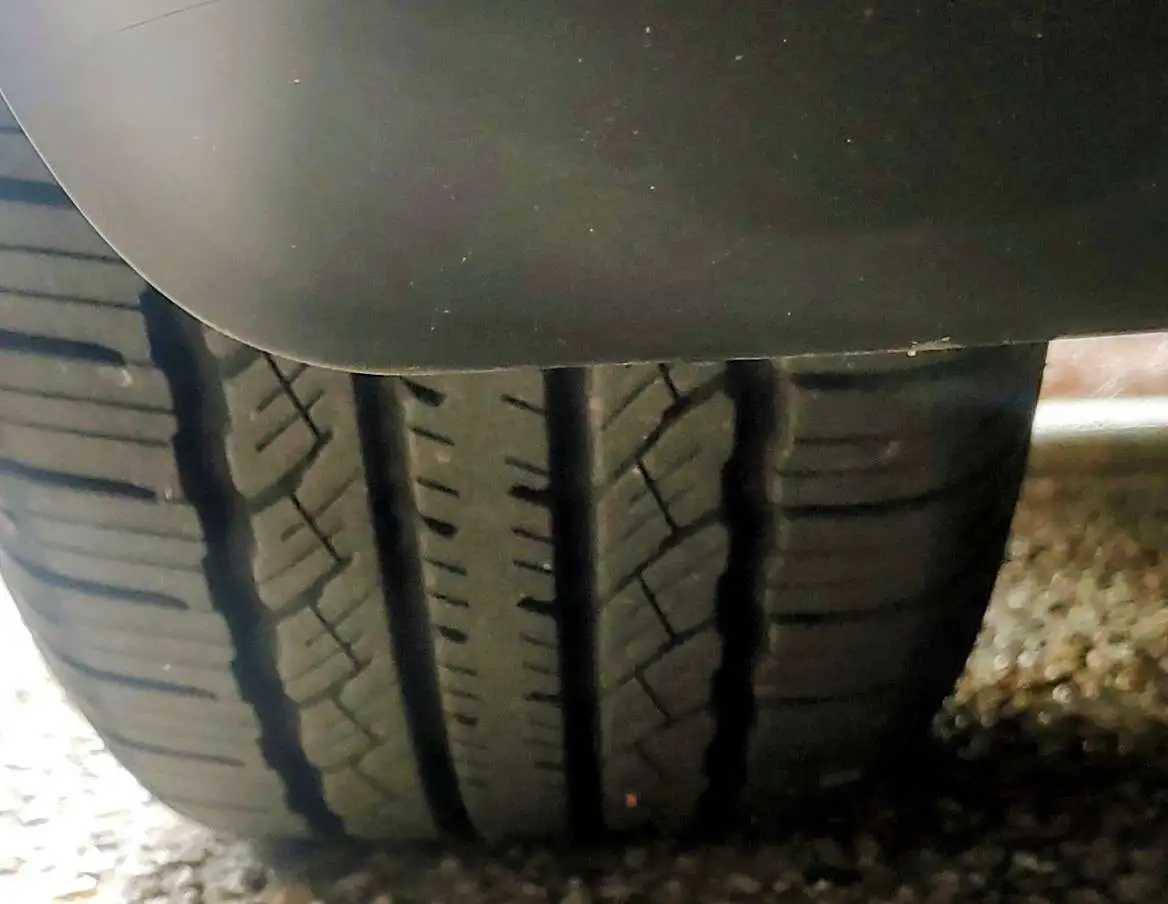

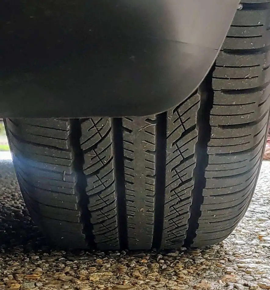

Here are pics of the front tires with 2 degrees neg camber.
I can see the inside tread is slightly favored over the outside tread of both tires.
We are accustomed to going +40,000 miles on tires. I believe 2 degrees will shorten tire life.
Can you see what I described as well?

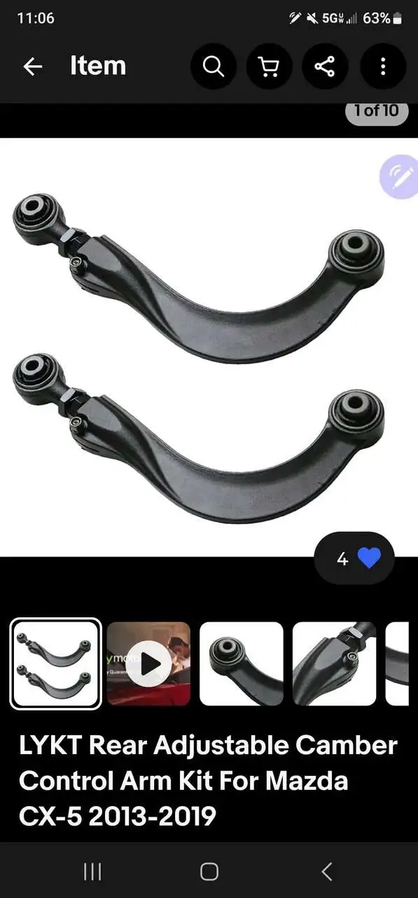

I searched Summit Racing and these aren't available for the CX-5. They're also bloody expensive.
Why not these? https://www.amazon.com/dp/ (commissions earned)
I believe that fits a 2nd Gen.
3rd gen has a different rear suspension. SPC is a quality piece and works. I don't buy on price on my suspension parts. Safety first.
I had to swallow hard and pull the trigger. They are way cheaper than a set of tires...
Specialty Products Company - Cx-5 Rear Camber/Toe Kit (67416) Vehicle Specific Item https://a.co/d/1xW8Wcf
2017-2024 have the same suspension in regards to camber arms. I know a couple of people running the Godspeed arms with 22/23 year models. Others are running the regular black ones that look more factory from Lykt purchased off of ebay.

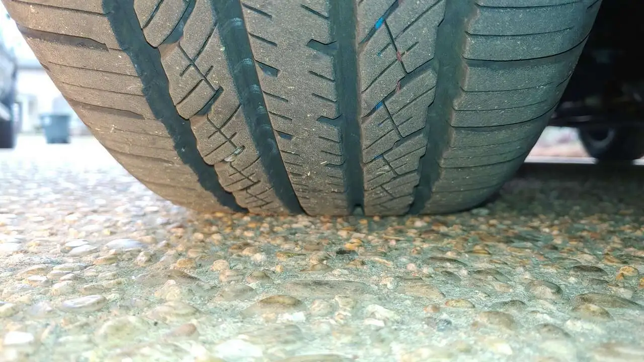

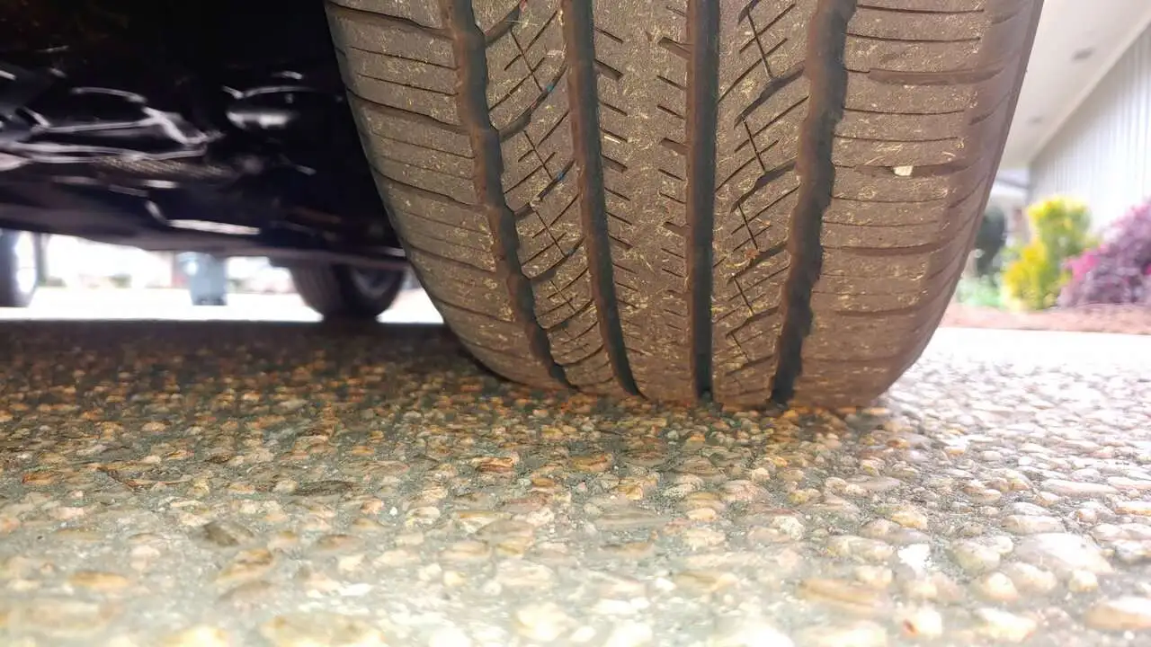

I installed 4 SPC camber bolts today. It took 2 camber bolts per side.
I sprung for a digital camber angle tool to get the camber to 0.1 of a degree.
Test drive, it tracks nicely, 2 fingers on the wheel. May not corner as well. That's ok.
Pics of tires now look about right for a DD.

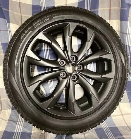

My wheels have arrived. I'm pretty excited and I want to get a coat of Gyeon Rim on them asap. But has anyone experienced wheel weights not sticking to coated wheels?

I order Gyeon Rim Coating today. Mount them Monday...
Guess I need to get some Gyeon coating for my new wheels as well. I may just stick with regular black lug nuts I have from Mazda. I wanted to do red ones but have not heard too many good things about them and that the paint/color tends to chip :(
I'm thinking I'll need something in gunmetal else I want them to contrast, which I think I don't. But I'm open to anything.
