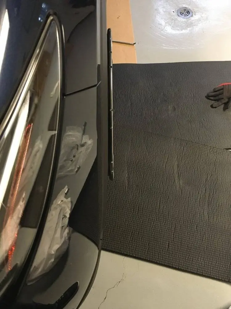

@dps03 and @prix57,
Can you guys put a straightedge (level, lumber, whatever) up against one of your tires and take a picture from an angle showing if there's any "rim protection" to the sidewalls or if the wheel and tire are the same width? According to specs on Tire Rack they are flush with each other, but it's kind of hard to believe without proof. Thanks a ton.
View attachment 304401This is a pic of a front wheel I test fitted for flushness a while back to determine whether on not I should purchase a set. The spec was 20x9 et 35 and you can see the wheel pokes a few millimeters. Since I want to run 255 tires, that’s too much protrusion for me. A 235 tire should give a more flush look. I’d think a 9.5” et 35 wheel would stick out about a quarter of an inch further. Hope this helps.
@ziggi would you say that's about 7mm out? So a +42 would have been flush?

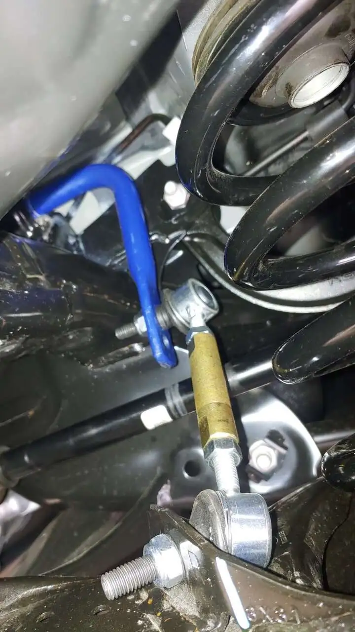

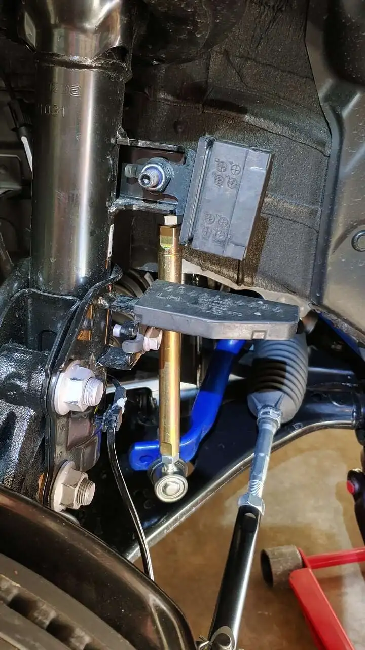

I'll put the end links on the tighter setting on the rear only and do an A to B comparison, then only the front, then front and back. This is my first set of adjustable bars on a street car. I'm curious.

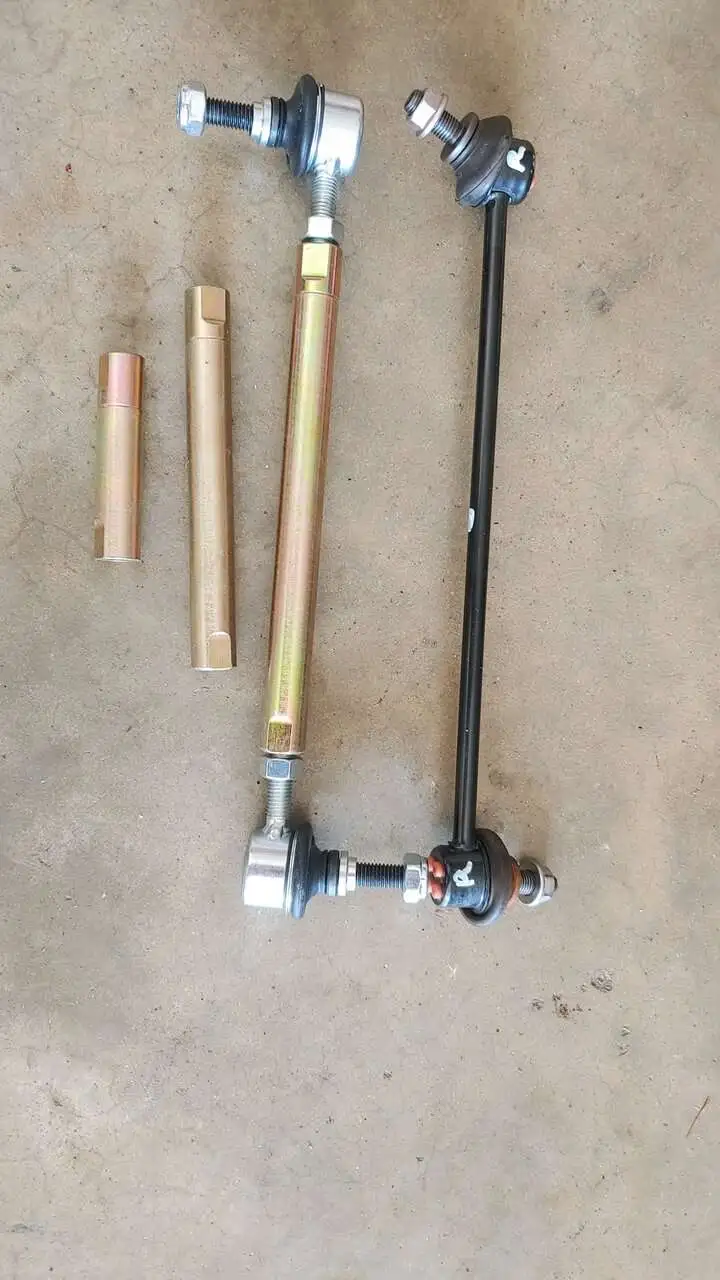

I bought a set of cheap/not race quality end links. I'll try these on the ASB stiffer settings and report back.
EDIT: Bought adjustable end links so I could use the inboard holes on the front and rear ASB. The car was a bit twitchy like a race horse ready to run until I lowered the tire pressure to 39 PSI. Now the car is rock solid and tracks very nicely.
I put the CX-5 into a couple of corners. The body roll is much, much less. The A36 tires are not up to this task.
On uneven pavement the body still rolls enough so the ride is firm but not harsh. I'm staying at the stiffer ASB settings.
Here is a link to the maXeedingrods. China stuff. Not race car quality. They have enough parts to fit the front and rear at stock height and when we lower it.
