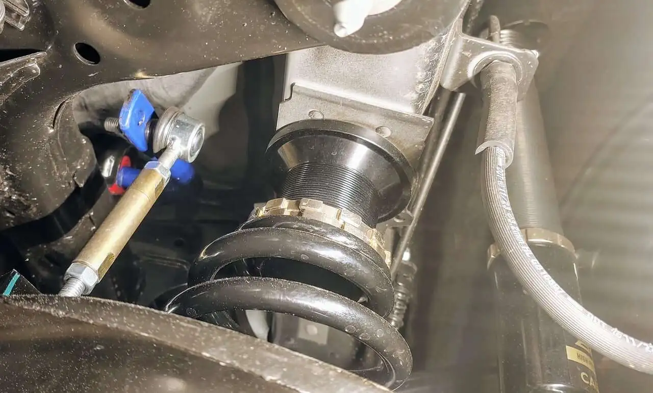

If you use adjustable coilovers, you can make the rear a few clicks stiffer to help with understeer. I have the rear 4 clicks stiffer than the fronts. 26 clicks from full tight on front and 22 on the rear. My wife drives this car. She wants more of a socker mom ride. So we compromised...:cool:
My rear Megan ASB is 19mm dia, same diameter as stock. But we don't know if the Megan has stiffer steel. I put Prothane urethane bushings, adjustable links and set it on the second, stiffest, ASB setting. The front Megan ASB, larger diameter than stock, 26mm, is on the softest setting.
I keep mentioning adjustable ASB links. On my race car, we go to great efforts not to have any preload on the ASB. We adjust with the cars wheels on blocks and add the drivers weight to the seat. This is a 0 to 60 is 1.4 second car. If it's not going straight, it's headed towards the wall, quickly. The same applies to our CX 5s. I drove it around with OE front links after lowering. It was a bit squirmy. I shortened the front links 2" from stock, rear until there was no ASB preload. I could tell a difference.

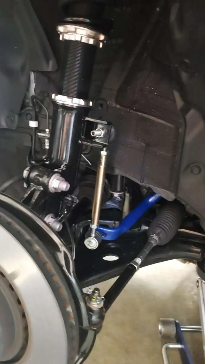

IF you use the Prothane universal bushings, you will have to cut the retainers to fit the rear stud spacing. I clipped them with a side cutter. I put the OE bushing retainers on top of the Prothane. They act like giant washers. Now I wish I had taken assembly pics. Here is the best I can get without taking off a wheel.
