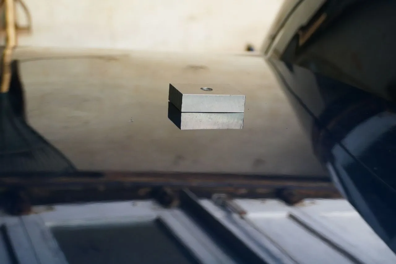

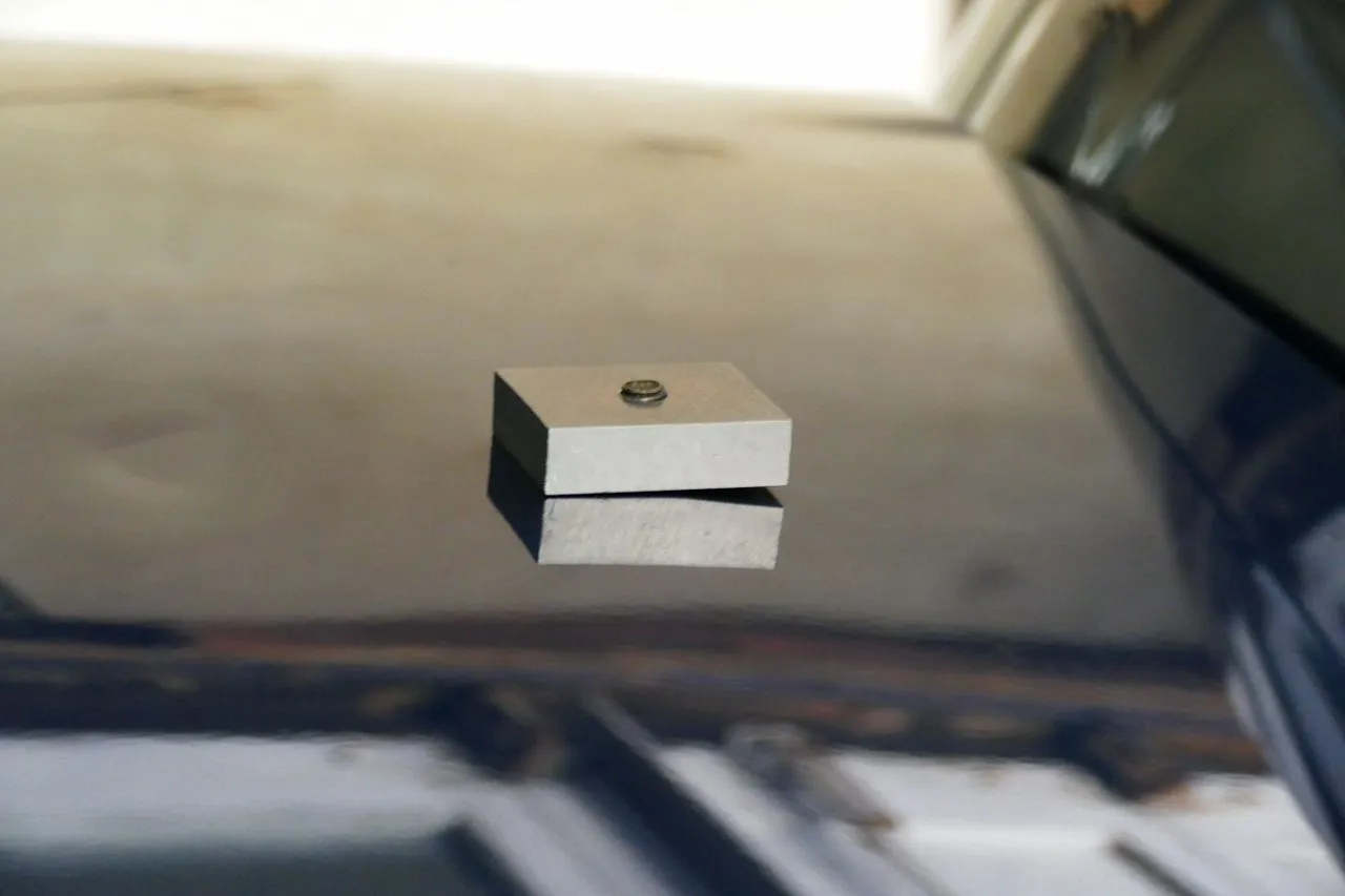

Taking a break. I think it didn't fit right is because the roof bent upwards where the hole is. I used a flat block and then a bolt tightened down from underneath to flatten it (Pic1 before pic2 after). I am hoping the antenna will now will fit nicely. My roof also has a slight impression in the front where the antenna sat. Not going to worry about that.

Was a piece of scrap aluminum, I was improvising. After using that, then I used a nut and bolt such that the head of the bolt caught on the edge of the hole on the outside, and I turned the nut on the inside to have the head of the bolt pull on the edge of the hole slowly bending the car's sheet metal back. You may be able to get a washer that covers the edges of the hole on the outside, have a bolt that goes through the washer, and a larger piece of metal or washer on the inside, and then the nut on the bolt you can turn to squeeze the car's sheet metal. Two things I remember to be careful of is don't let the headliner bend too much, it really seems fragile and easy to get messed up, and if you decide to remove the trim between the front and back doors, I guess it is the B pillars, be careful popping the plastic pins out of the frame holes. There is one pin on one side that got a bit messed up, and it didn't click in with a lot of holding power. I have long thin hands that helped, working under the liner. It's not a job for the faint of heart, from my recollection. If successful it is impossible to tell that there was ever an issue. I coated the hole with anti-rust because the process chipped the paint a bit on the edge of the hole, and I put a thin film of silicone around the edge of the antenna to make sure it was sealed well and water tight.

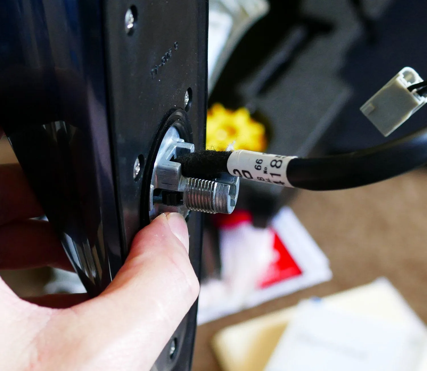

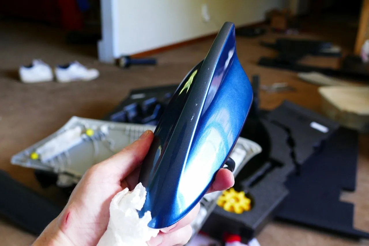

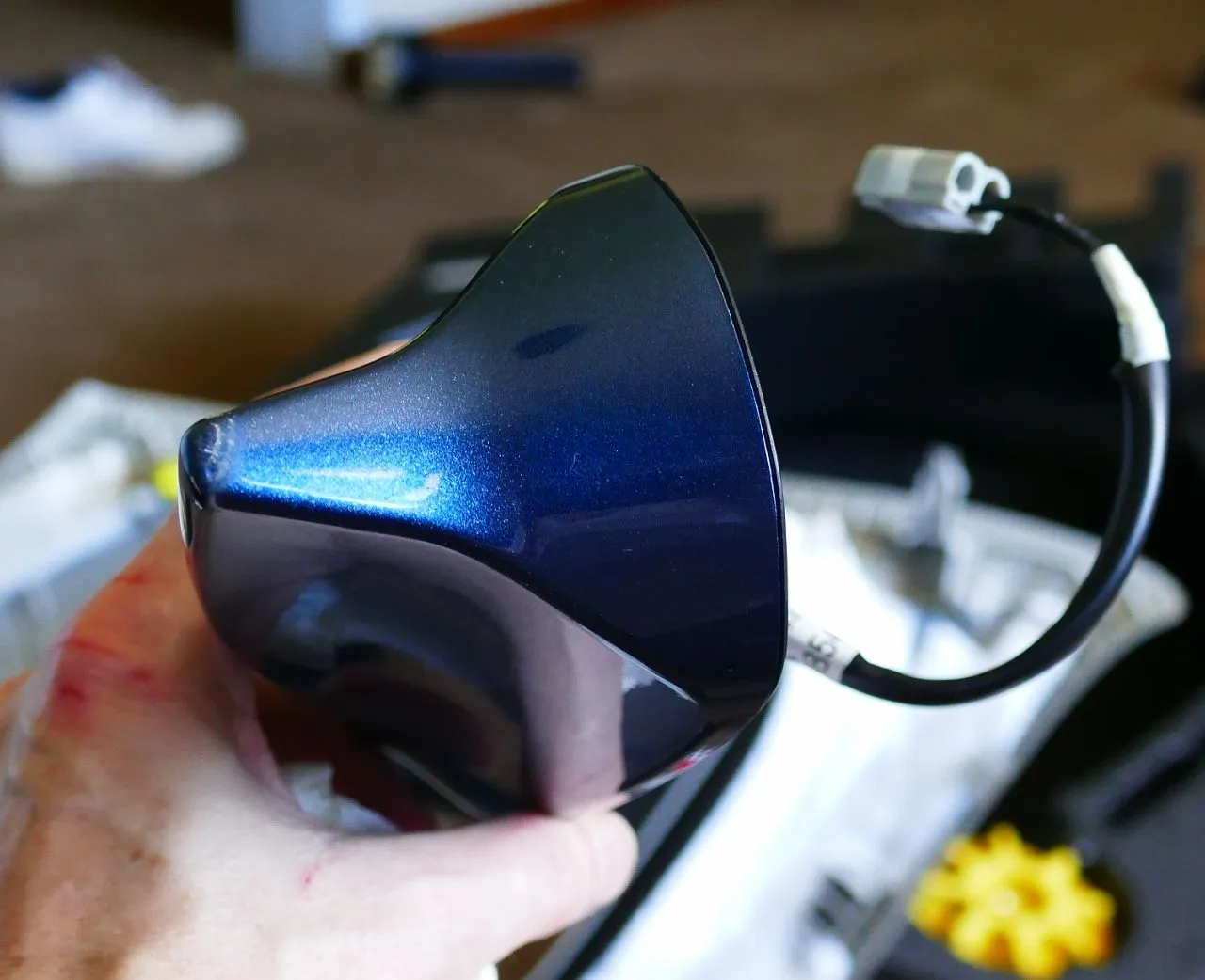

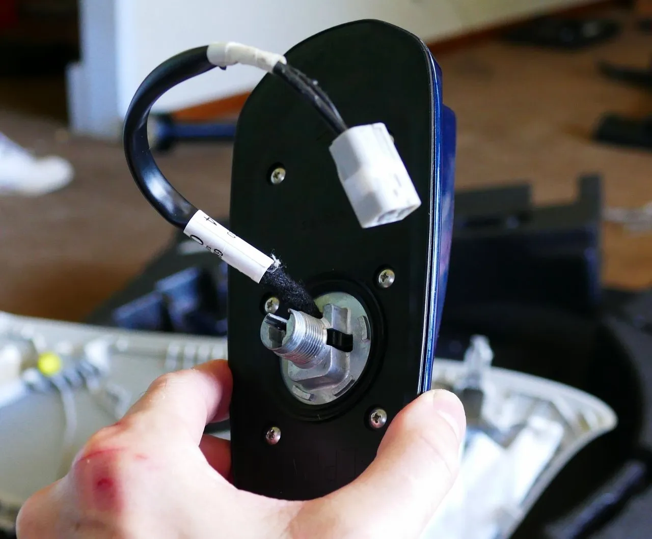

I got it off. The stupid clip was easy after all, the push down levers were on the opposite side of the plug to pull out. To get the antenna out had to squeeze the two tabs and push from the inside. The antenna looks fine, I was thinking the metal connection pulled out from it, but nope. Now I have to figure out why it doesn't fit flush on the roof.View attachment 226492View attachment 226493View attachment 226494View attachment 226495View attachment 226496

I didn't need any tools to remove it, just squeezed the tabs with my fingers and pushed. Mine may have been easier because of being struck by the garage door.
