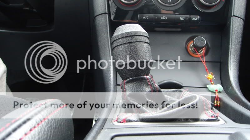

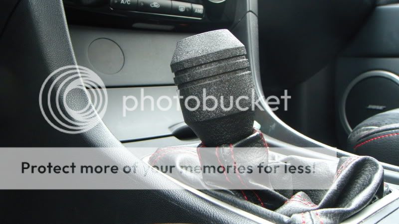

Damn, how much lower is the shifter from stock?
The shift linkage that's connected to your short shifter...the one with the white plastic cover on it...you need to mark how it sits currently, then pop the piece so it can slide freely, adjusting it a TINY bit at a time either up or down from your mark until everything shifts smooth...Hope that helps.
Because I do a lot of snowboarding up at Tahoe. Almost every weekends.
Yeah I just watched a video of how to do it, on J Barone's page.

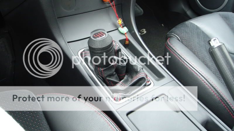

What if I tell you the *THUMP!/THUD!* noise/sensation is coming from the engine bay compartment. Will adjusting the linkage help in that case?
Do you have a RMM on it? I would be checking the bushings for the "arm" that's attached to the RMM cuz that would cause that also...don't think it's your shift linkage in this case then....unless you have a CAI or FMIC it that the weight is knocking into the pipe on hard shifts.??
