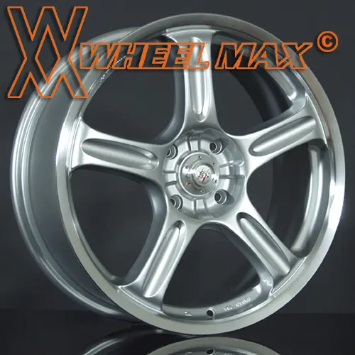

I am looking at 18" RH Evolution GT5's.
1. Do they come in the correct offset?
2. Can you get those, and if so how much for a package.
Thanks in advance.
Eric
