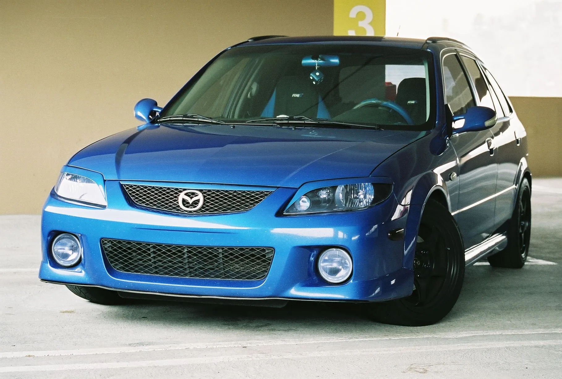

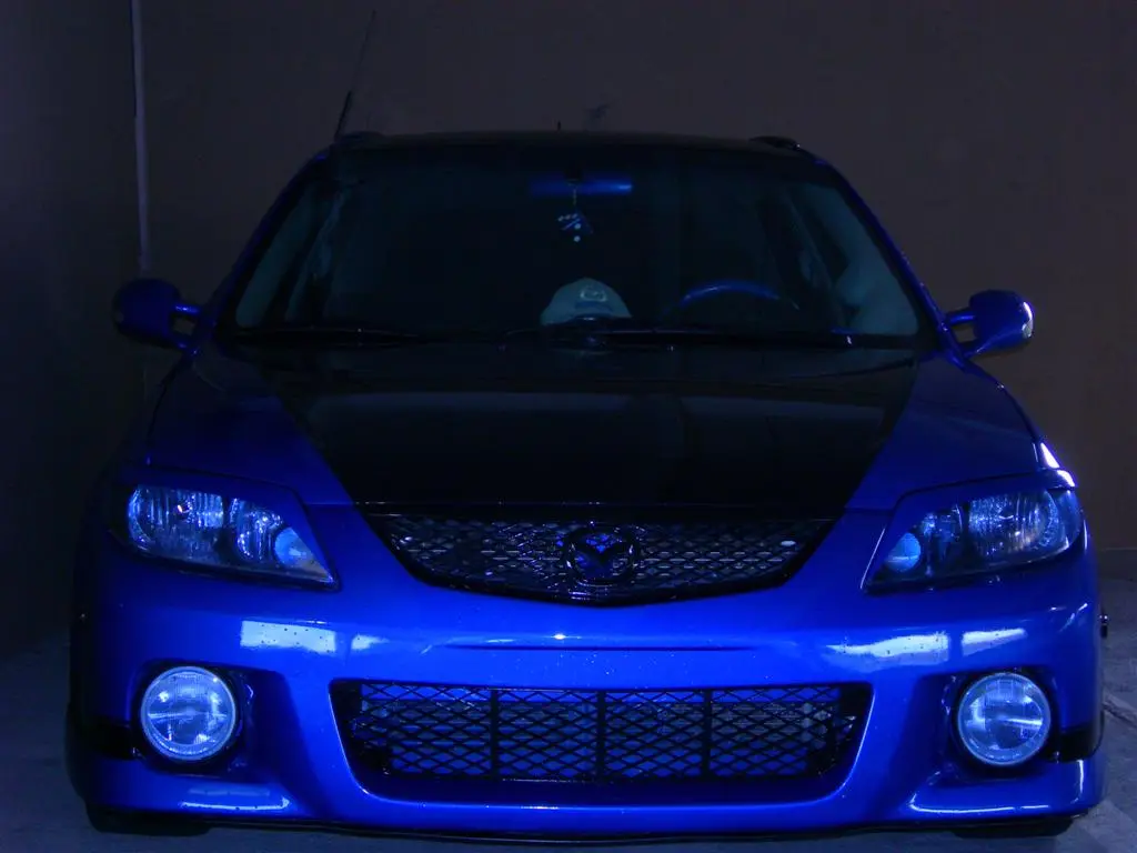

Chrome polish works well. I did that just before having the rockblocker light protection installed ( www.rockblocker.com ). The combination between polishing my headlights and the light blue rockblocker you couldn't see the chips in the headlights any more.

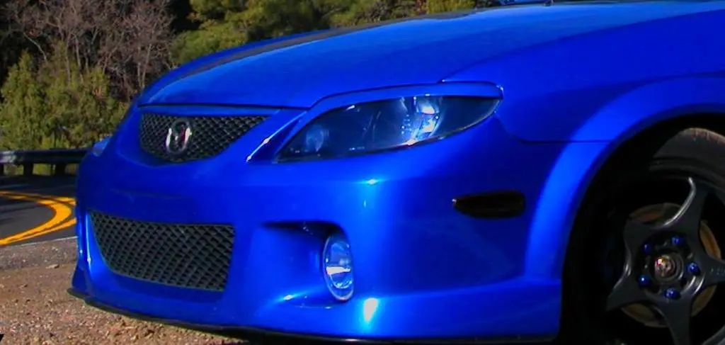

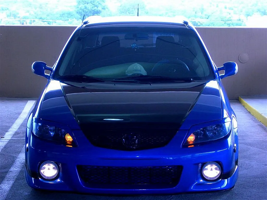

Btw, redneck, do you have a close-up pic of your headlights? I was wondering what he rock blocker actually looks like on them.
