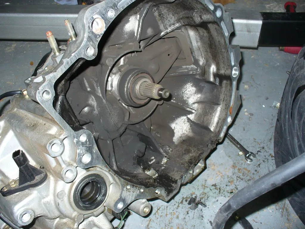

don't see what you're talking about. see my post above where i circled the rear main seal housing and look at the transmission pic here.

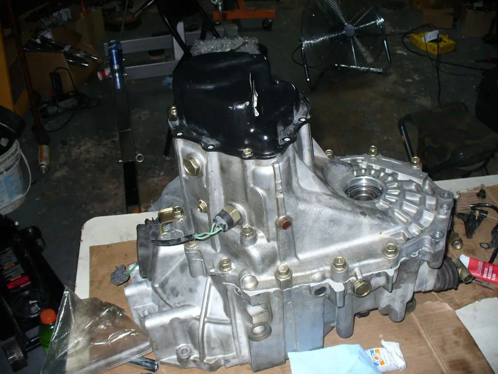

I think someone drilled your transmission case for you. b/c heres the bottom of a MSP tranny case.

I'm sorry sam, I've got nothing but respect for your knowledge with this engine, but the boots are there and they are specifically for that...and you can see that if you look at your transmissions in person on the outside of the housings...see the picture I posted above (which was my old trans from the protege, not from the probe)
I think someone drilled your transmission case for you...
nope, cause this wasn't on just the one transmission...it was on both of the 3rd gen trans I've had, as well as on Brandon's spicy msp (msp1222), as well as on Greg's LX (xdj_dubx)

Well look at the pics of the the one I posted. I have pics of various cars I did and none of them have the holes shown in your picture.

and I did look at the picture you posted, idk if the transmission is just grimed up too much inside the bell housing to see the holes or if that trans isn't specifically from a 3rd gen 2.0L protege...but I know for a fact that those holes and gromets are there on every single msp I've done oil pans on
