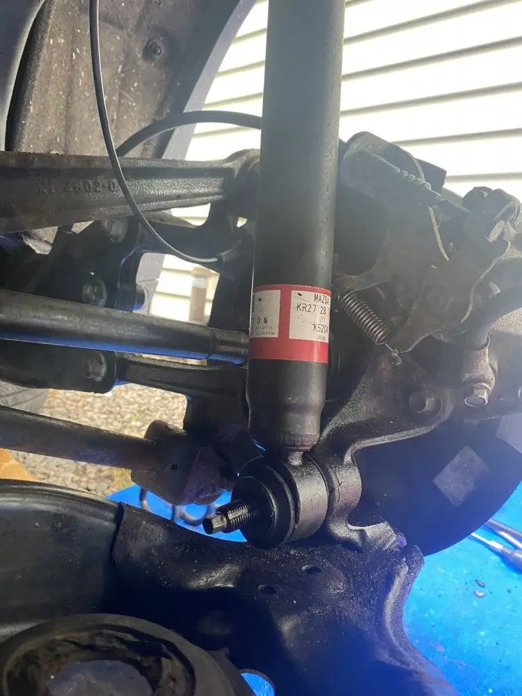

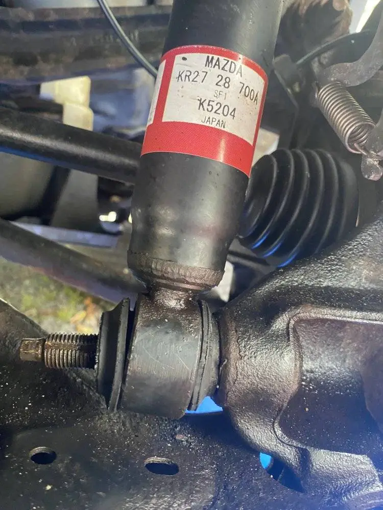

I have a cx5 15’ and have been trying to replace the rear shocks but I just failed miserably. To access the bottom bolt on my vehicle, I have to remove the coil spring and lower the knuckle. I got the bolt and the washer off no problem. I then went to slide the shock off but it literally would not come off. After trying for an hour I gave up and put everything back together. Are the two boots on each side suppose to be seized to the shock?

Could it be the angle? Can you compress it a bit so the bolt is perfectly 90*?
Will try it out later this week. Honestly I tried compressing it and it didn’t work. May be I need to hit it with a hammer aswell while it is compressed. If I can’t, I’m probably just gonna return the shocks and wait till my stock ones start malfunctioning.

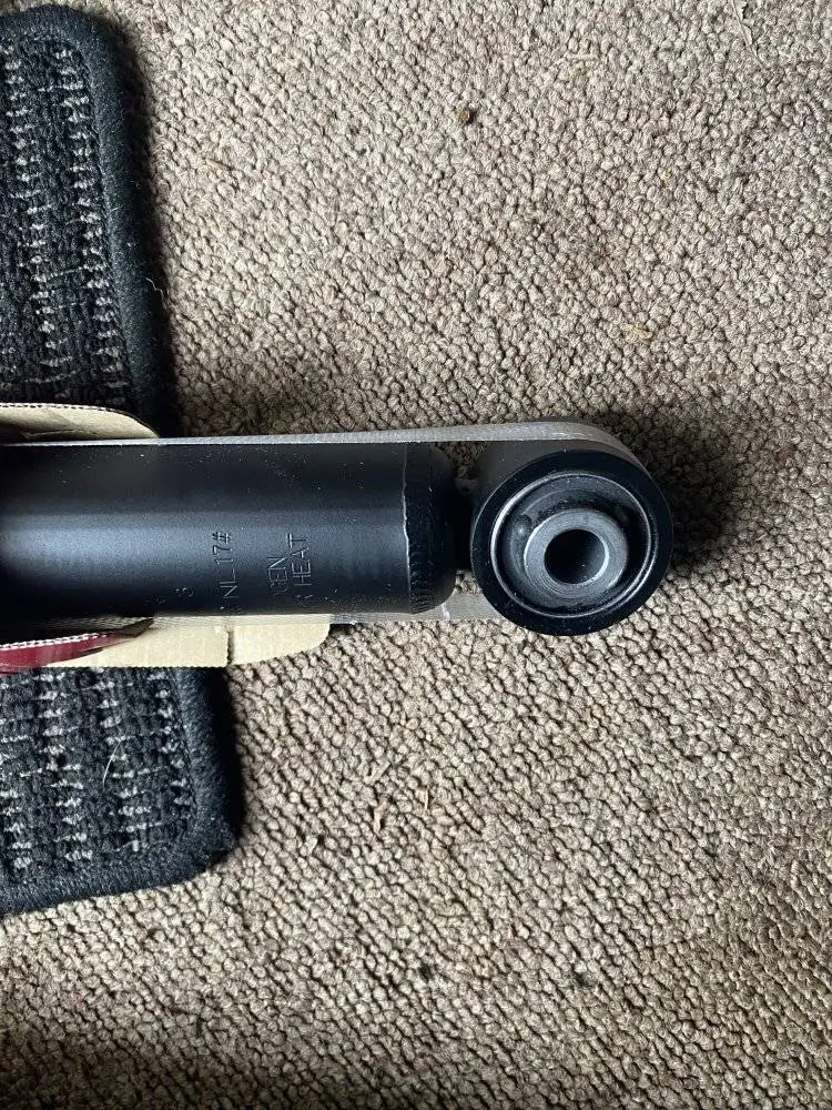

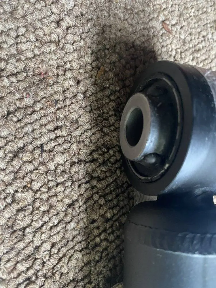

Can you take a picture of the new shock? I want to see if there are the "boots" on the new one. Spray some penetrating oil and whack with a rubber mullet. Good luck
The new ones don’t have boots which is why I think I have to reuse the boots.

I think the boots might just be there to protect the bushing? You can also try this.. unbolt the top, compress the shock & strap it down, and wiggle the shock off.

A couple people say to remove the 8mm hex but a couple then say that it is dangerous. Even if I were to remove the hex the shock will still stuck. Ahhhhhh
I agree with Silly Wabbit: Based upon your photos, it looks like the angle of the shock is preventing any sliding off of the threaded bolt. I think you must get the bolt to be parallel with the shock mount hole.

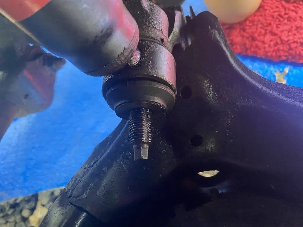

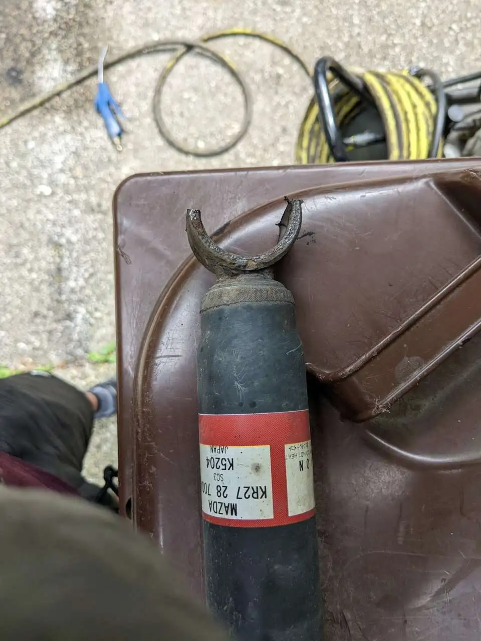

So I just replaced my rear shocks this weekend and had a hell of a time getting the bottom mount off the stud on the hub. I tried backing out the stud with the 8mm hex but it rounded. If that is the case, I wanted to share how I got the bottom mount off in case anyone else runs into this.
First, you need a form of metal cutting tool. I used an angle grinder with a 1/8" disc. For the cuts, I made two cuts on the outer metal tube of the bottom mount. The front cut is a little tricky cause there's a lot of arms and axles in the way but it wasn't too bad. The rear is easily accessible though. This allowed me to remove the shock itself, but the rubber bushing and inner metal tube of the mount were still there attached to the stud:

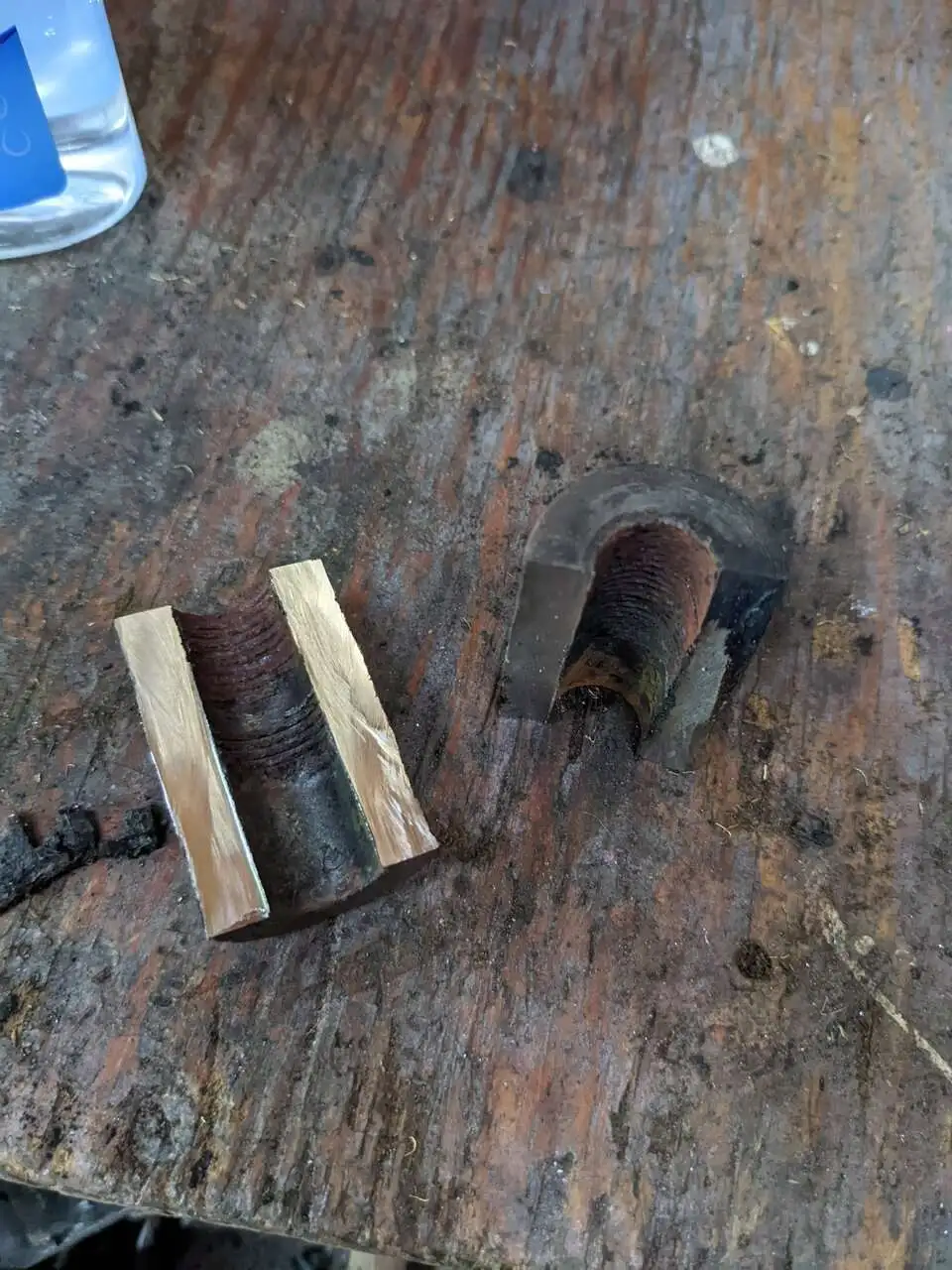

Then I was able to remove the rubber bushing with some box cutters which easily came off. Now the inner metal tubing of the bottom shock mount just remains on the stud. I was able to get a pipe wrench on it and when i turned it, the whole stud ended up backing out. Once I got the stud out, I took it over to my vice and I carefully (without damaging threads) made two cuts on the inner metal tubing of the mount in order to get it off the stud:
You can see how the threads of the stud dig into the mount and cause it to seize up. A pretty stupid oversight on Mazdas part. Looking at parts diagrams online for these studs, it looks like they now just use a bolt with a larger head on it. If I would've known ahead of time, I would've ordered these and replaced the original studs with these instead of having to cut the mount off the stud.

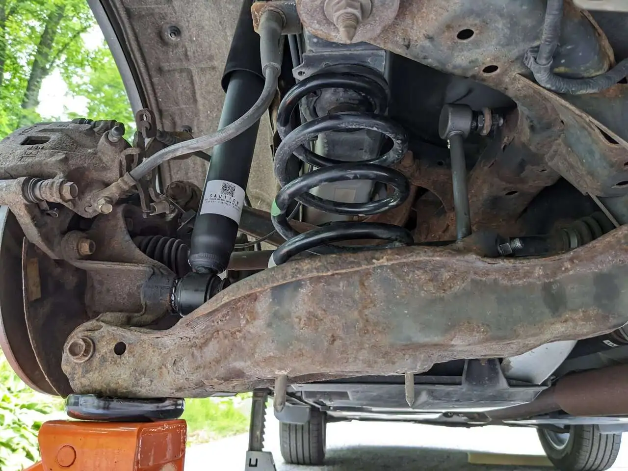

Anywho, I then cleaned up the studs with a wire brush and reinstalled it into the wheel hub and installed my new shocks and moog endlinks :cool:

I just had mine replaced. Some recommend removing the stabilizer bar and/or control arms. My mechanic drove the mounting stud out. I don't know how much trouble that was, but I'll recommend a tall nut or threaded tube to reduce damage to the end of the stud.
