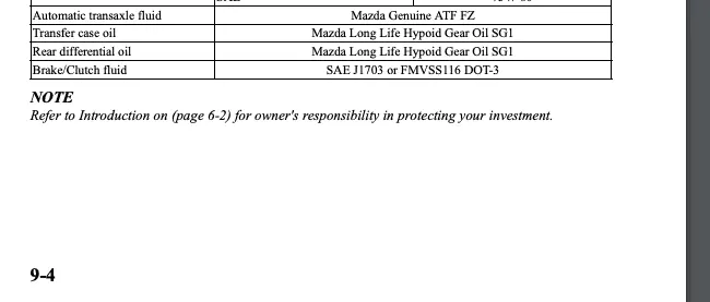

Yes, you’re correct. My 2016 CX-5 owner’s manual does have that paragraph with different gear lube spec. But I consider that is part of errors Mazda made when they changed the gear lube spec but failed to modified the maintenance note accordingly. Or I can’t think of a reason why Mazda changed the gear lube to a proprietary type SG1 which is a lot more expensive.
For OP, this won’t be an issue as Mazda has eliminated that piece of gear lube replacement paragraph since 2017 gen-2 CX-5 owner’s manual. At the same time Mazda also reduced the fluid capacity on rear differential from 0.48 quart to 0.37 quart.
I know it will always be up for debate but I would never consider SG1 basically lifetime fluid but that is just my opinion from a long term ownership perspective. I would change still change it at intervals.

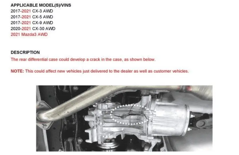

There is still this potential issue with cracked rear diffs of '17+
The car arrived there last evening. Service called early this morning and said they'd get right on it. Got a call back about noon. They determined that it is the differential, and it is covered by warranty. They said that “Mazda was aware of it, and they had had a bad batch.” New dif should be there Monday, and I should be able to pick the car up Wednesday. No problem no fight.

According to the TSB on cracked rear diffs, do we still need to disable the EPB first before starting car?
Without pressing start button, I depressed brake pedal while pressing EPB button and orange light flashed then turned off a second later BUT I don’t hear the EPB disengage.
I am worried 😳.
