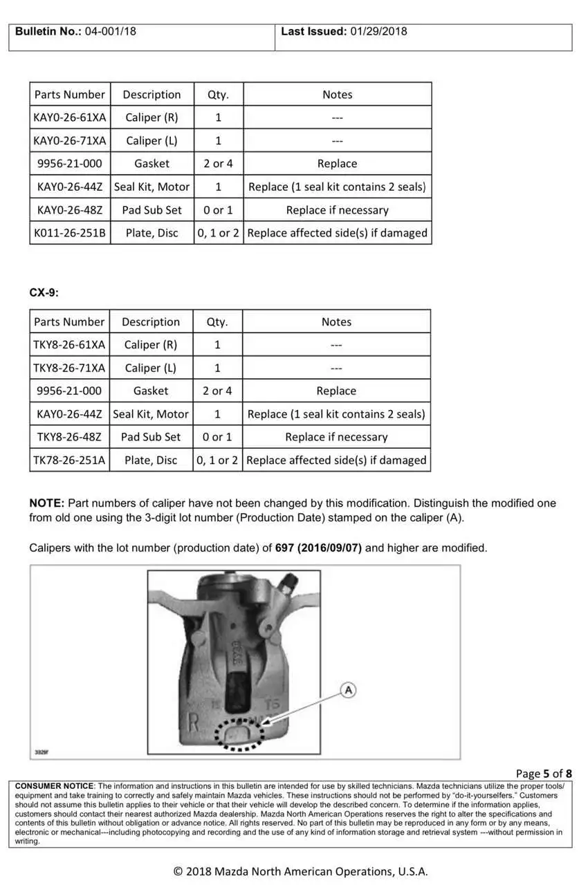

Here is rear brake parts list for 2016 CX-5 from a EPB related TSB:
TSB No. 04-001/18: Noise from Rear Brakes Due to Brake Dragging

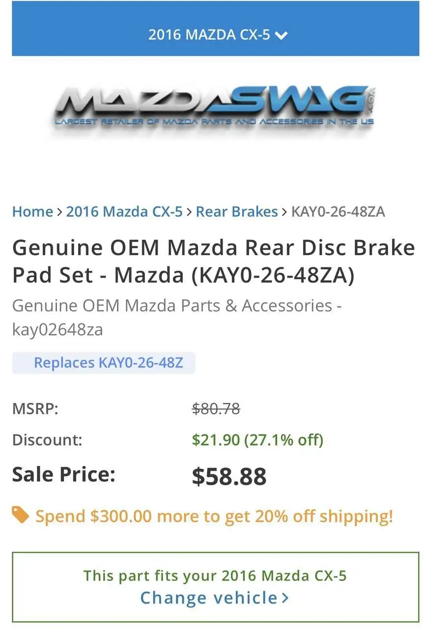

Here’s standard OEM rear disk pads KAY0-26-48ZA:

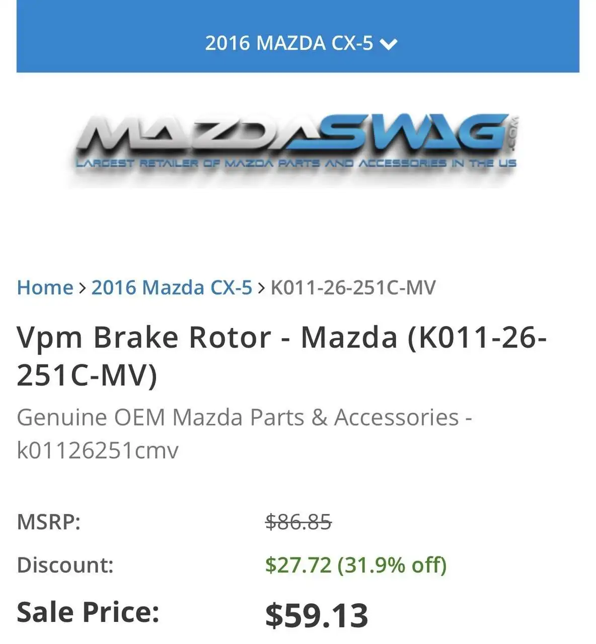

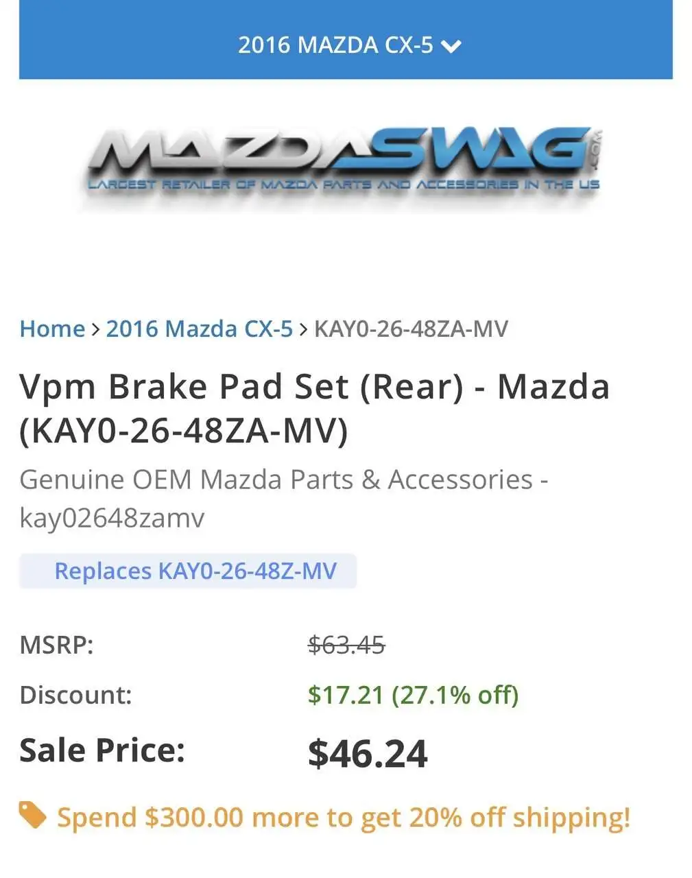

Here’s “value” OEM MV rear disk pads KAY0-26-48ZA-MV:

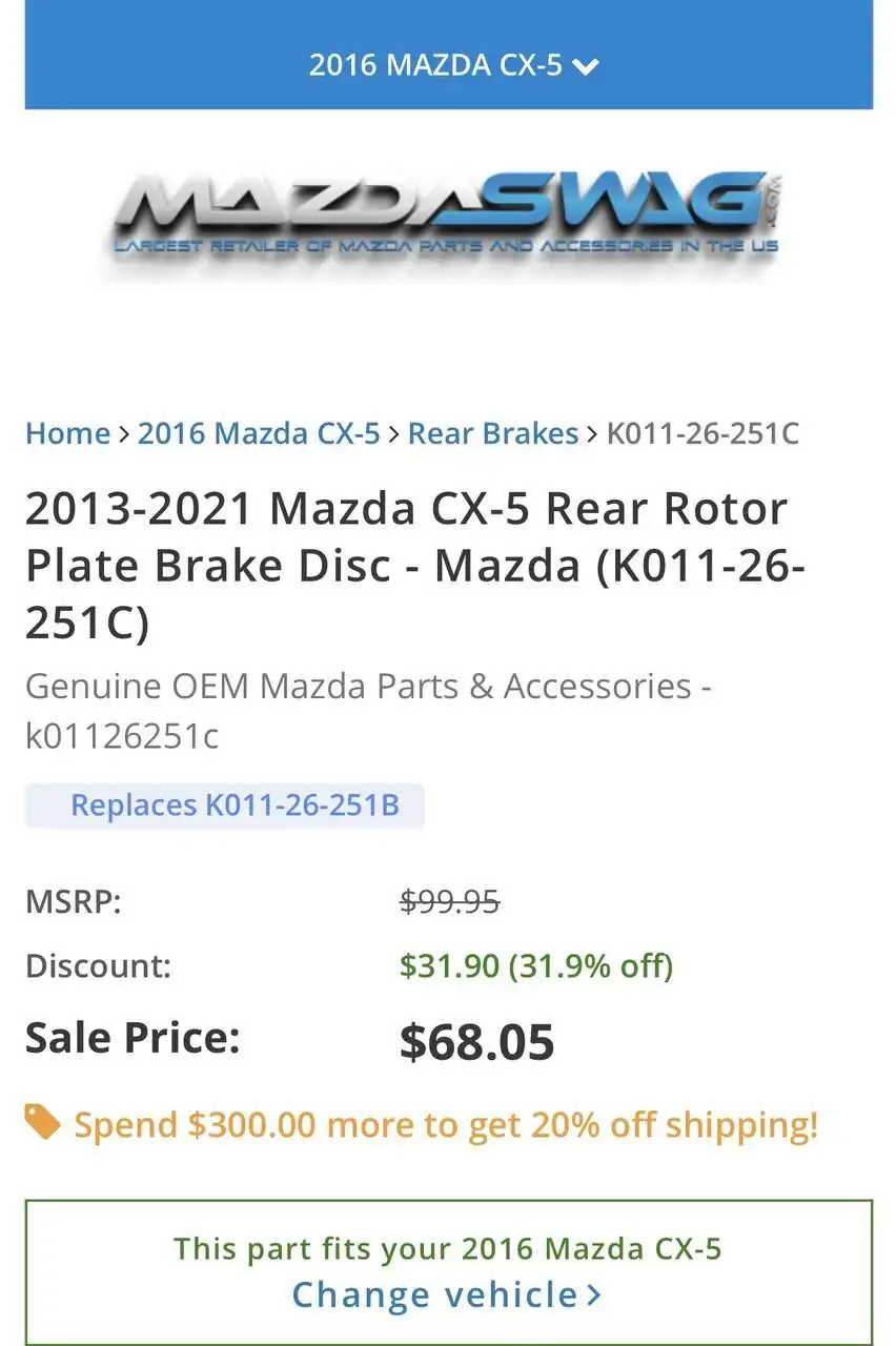

Here’s standard OEM rear disk rotor K011-26-251C:
Here’s “value” OEM rear disk rotor K011-26-251C-MV:

However, I see the posted TSB: TSB No. 04-001/18: Noise from Rear Brakes Due to Brake Dragging. But I've had no brake issues. With this in mind I'm a bit confused about doing this brake job myself.

Identify the OEM “Value” parts is easy, they always have “-MV” ending on part number.
The caliper problem with EPB on the TSB shouldn’t affect the intention of DIY brake job as it’s a separate issue. Your 2016.5 CX-5 is in borderline on this inferior rear brake calipers with EPB. If the lot number / date code on the caliper is after 9/7/2016, you have the updated caliper. If this’s your first rear brake pad replacement, your rear calipers may be fine without dragging problem otherwise your pads won’t be evenly worn and lasted this long at 85K miles. But make sure to check the lot number according to the TSB.
