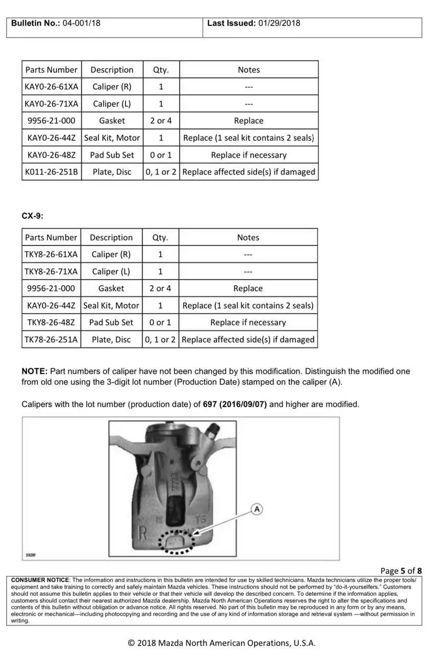

Here is rear brake parts list for 2016 CX-5 from a EPB related TSB:
TSB No. 04-001/18: Noise from Rear Brakes Due to Brake Dragging

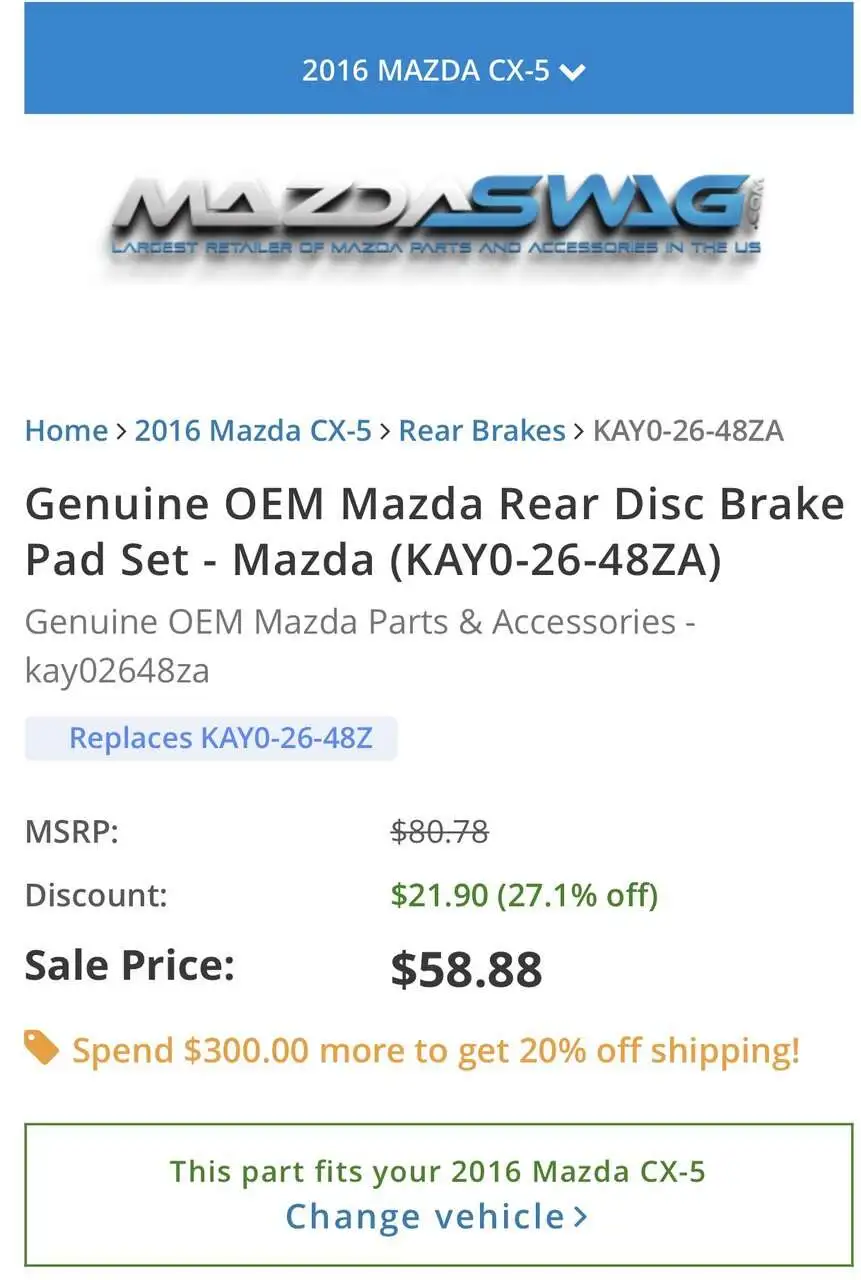

Here’s standard OEM rear disk pads KAY0-26-48ZA:

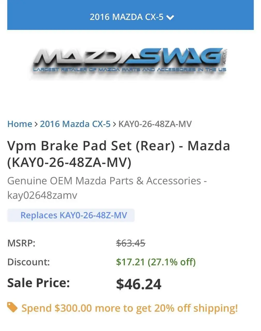

Here’s “value” OEM MV rear disk pads KAY0-26-48ZA-MV:

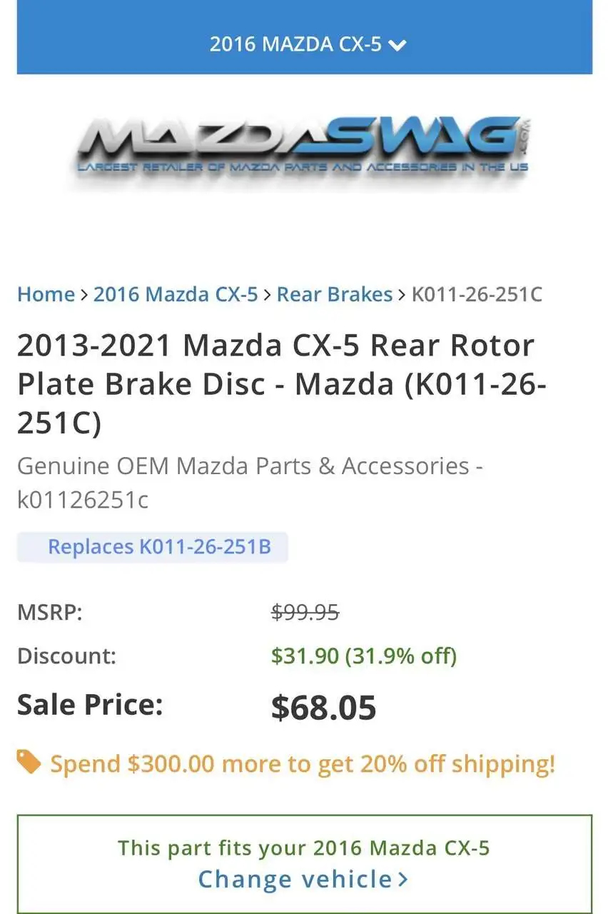

Here’s standard OEM rear disk rotor K011-26-251C:

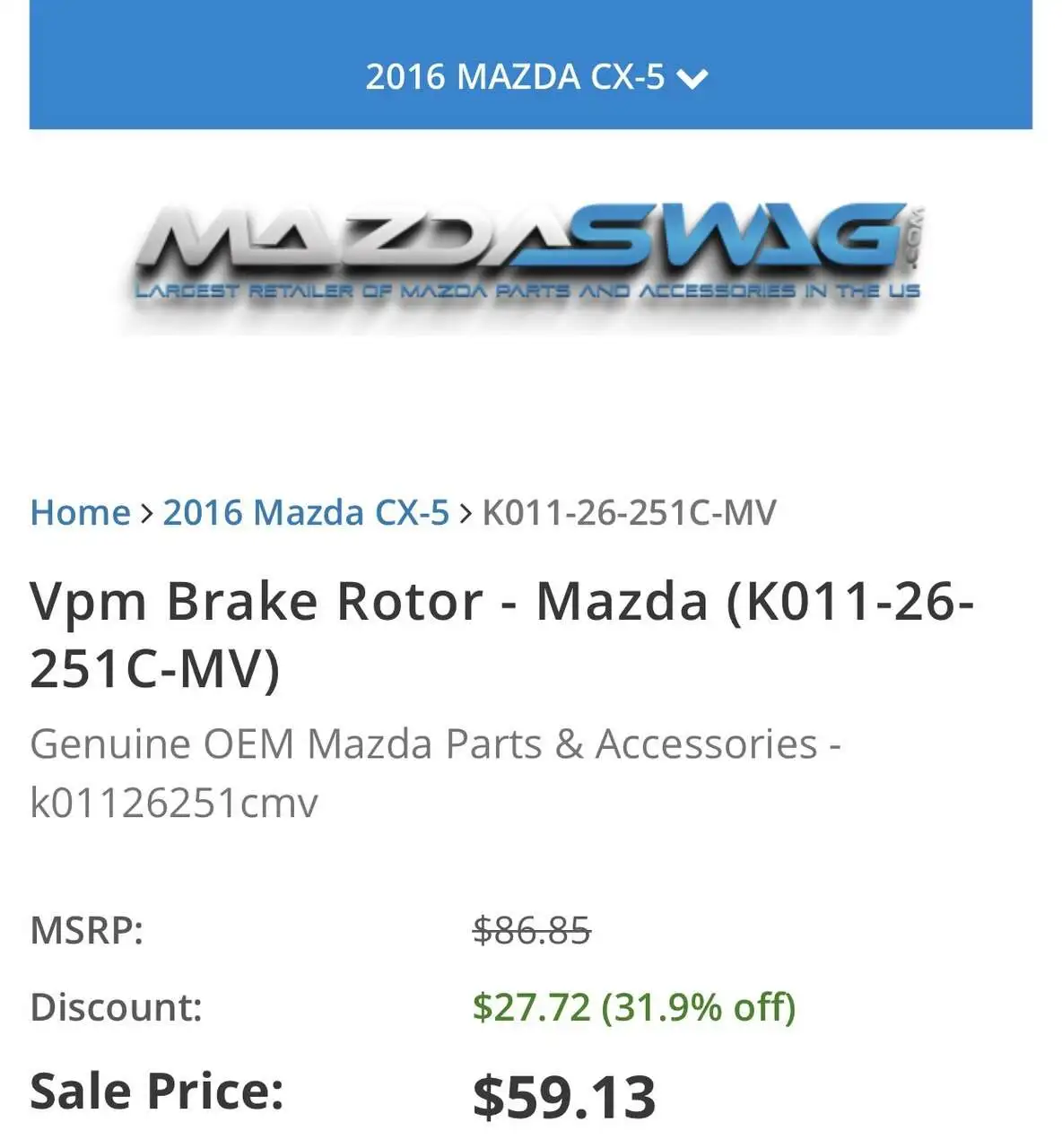

Here’s “value” OEM rear disk rotor K011-26-251C-MV:
