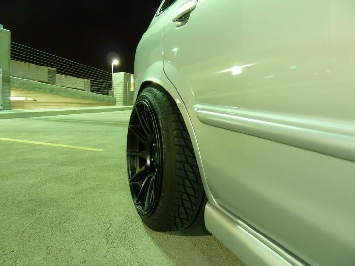

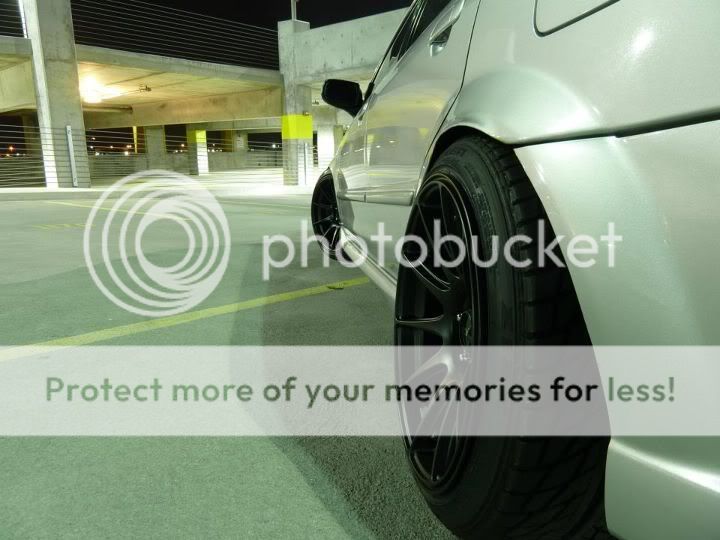

that was at what offset width and camber? im going to be fitting a pretty aggressive set soon, let me know.
Offset was at +25 and width I'd 9.75 offset and camber was 2.3 or 3 that was stock camber on my coilovers u might beable to slot like a mm and go little more but not much room with the strut
I think I had 8 to 5 mm's of clearance from the strut no spacers no slotting of any cind just used the stick slotted canber with the coils. Civickilla if I was u get the get the k spot camber plates in the rear they are only 200 dollars and they bolt right up to ur coils and add 1.5% of camber and if need be u cam slot like a mm or 2
i can get 2 degrees from direct slotting, camber plates wont help me much, in respect to how much i would have to pay for them. and fyi....dont measure camber in percent lol
but thanks, just the info i needed
Alright man. U got a piont there u can just get away with slotting man and good luck on fitting the new wheels man
