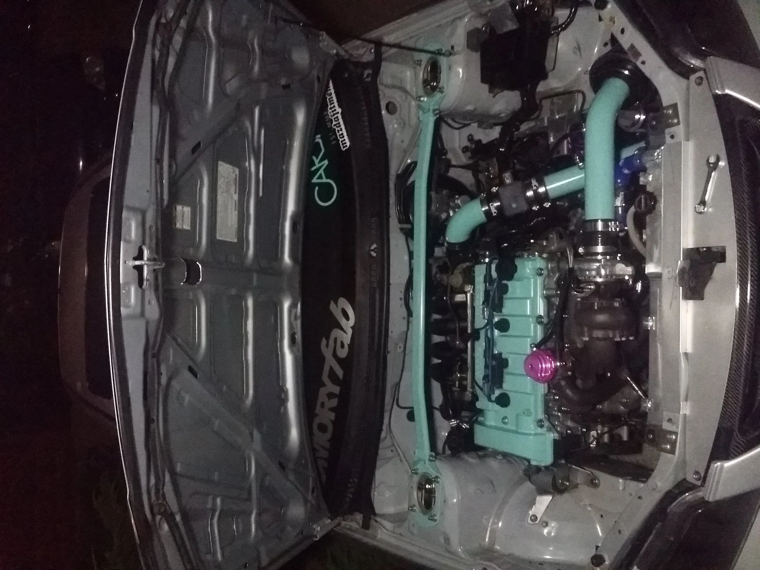

I would suggest replacing that 90 degree coupler with a silicone coupler. That looks like the one from the Injen intake setup and isnt really meant to take boost. It would split pretty easily under pressure. I know youre running low boost but just to be safe.
Ya I know I need do a hard pipe there I think I can make a hard pipe and it is a the injen one

Hey guys took a pick today here is what my my engine bay looks like added a hard pipe right before the intake maniuploadfromtaptalk1445312689613.webp
