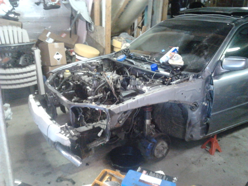

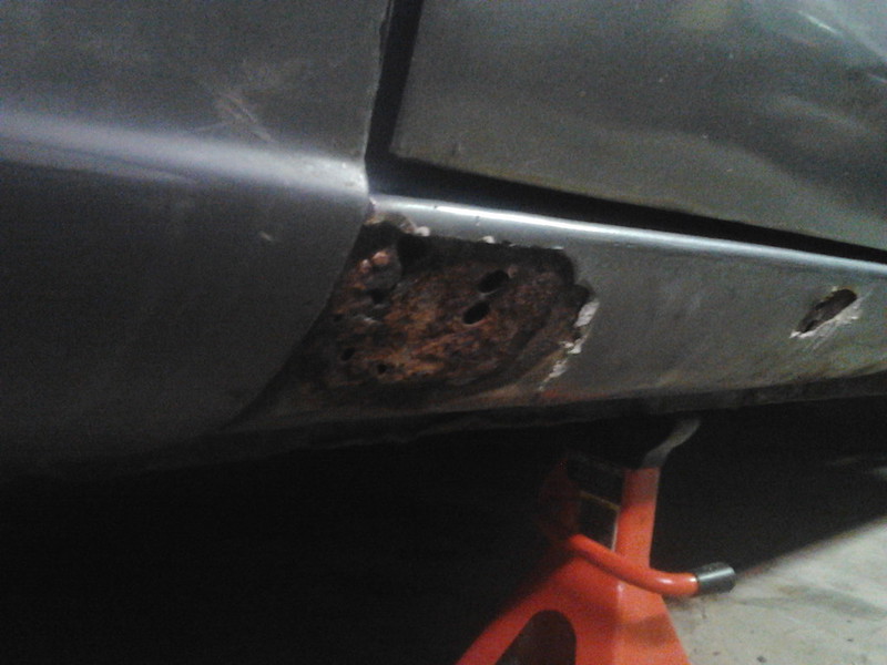

Took of the side skirt on the side that was T- car and now see how shady their work is. I always wondered why that side skirt didn't fit like the other side. I saw blistering and sanding marks on the rocker panel and chipped a piece of what I thought was rust off to find out it was a wall of 1/8" thick od bondo with a thin layer of rusted rocker under it :( I really don't want to undo the whole left side of the car right now down to bare metal, because I'm affraid of how bad it really is. Lip, front bumper, both fenders head lamps, and side skirts are now off. I drilled and tapped new holes for all of the broken bolts in the fenders. I need to get new head lamps (mine have broken tabs), some techflex for the wiring, and another left side fender to use as a mock up because mine has a bad bow in the top were it sits on the frame rail. I have the foam to start mocking up the core form of the fender.
