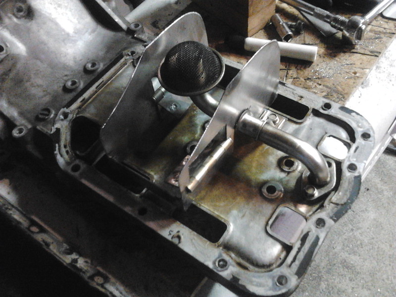

Buhahahaha, the test piece for the trap door oil pan baffle is done. It fits a little snug, but looks like it will work great. I might have to give it a little more clearence on the next couple I make and see if there is a better fitment for easier installation.

That looks pretty damn good. Much like many of the ones built for other cars. The location of the trap doors, are they in a spot where they would always be submerged in oil(assuming your fluids are full)?
Because of the pickup location on the one side the door is a little higher and between the 2 and 3 quart area, but the other is close to the 2 quart line. There is a margin around the piece in certain areas that allows oil to flow from chamber to chamber to help level out the oil when flat.

When does testing start? Whats the best way to monitor that everything is good?
Testing starts when I install my new dp and exhaust manifold studs. The only way to really test it is by running it on the street and autoX and observing the oil pressure. There isn't really any other way to test it. It did some testing with it just in the pan it everything flows good. Even with just 2 quarts in the pan it keeps the pickup covered. I did it with 2 and 3 quarts because there will never be a full 3.73 or 4 quarts in the pan while runing. 2 quarts seemed like a more likely number since I couldn't find the flow capacity of the stock oil pump.
