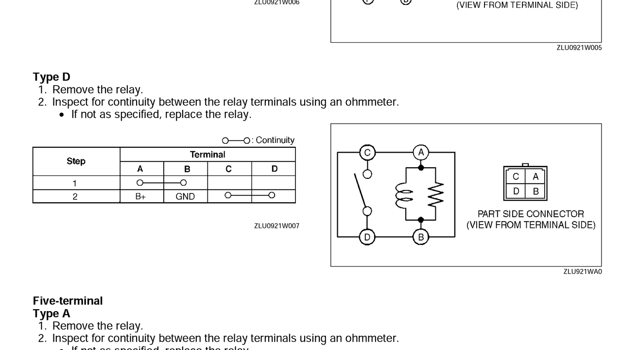

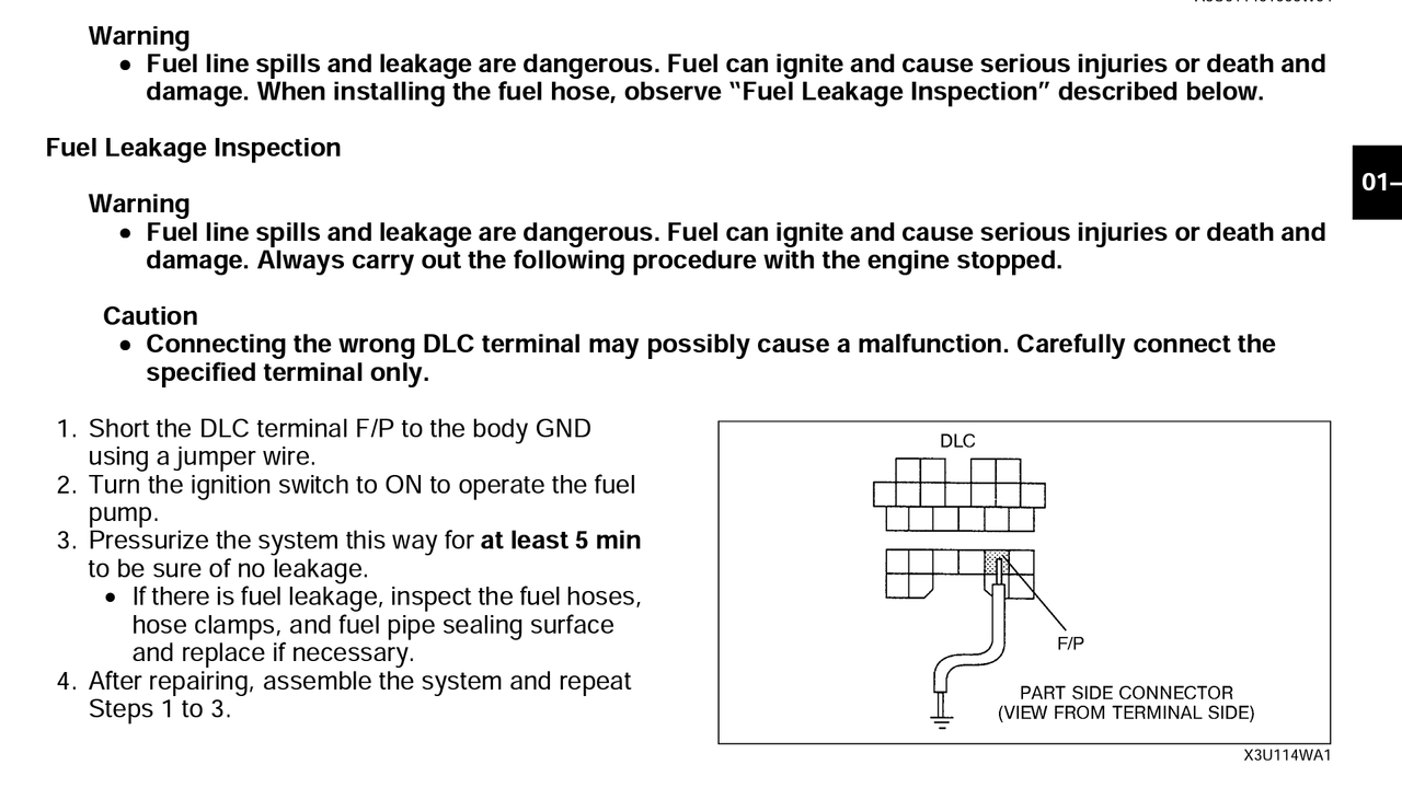

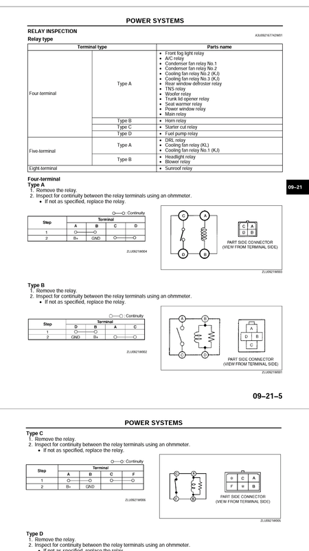

I checked for spark and there was no spark. Also the engine fuse is perfectly fine. I have not tested the relay yet. What should I check for next to get the fuel pump running (there is no pressure in the fuel line).

I made sure the pulley is right, and checked, there’s still no spark. I tried checking for continuity in the camshaft and crankshaft works and I couldn’t get it to work. Do you have any tips to do that? Also checked the fuel pump relay and main relay they’re all good.
