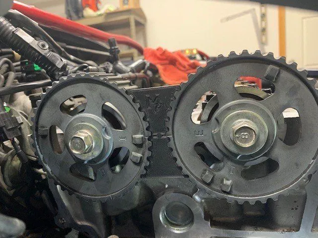

Hello, thank you for the reply. I fixed timing by taking off the timing belt and realigning the camshafts and the crankshaft.

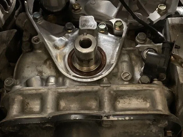

If it skipped timing, how many times did you rotate TDC for #1 cylinder? When timed right it should look like this. I and E facing each other, and the Crank key way at 12 o'clock. #1 cylinder at the highest point (TDC)
..., and the Crank key way at 12 o'clock. #1 cylinder at the highest point (TDC)
There's a notch in the crank gear that shows TDC.
IIRC, the notch doesn't line up exactly with the keyway.

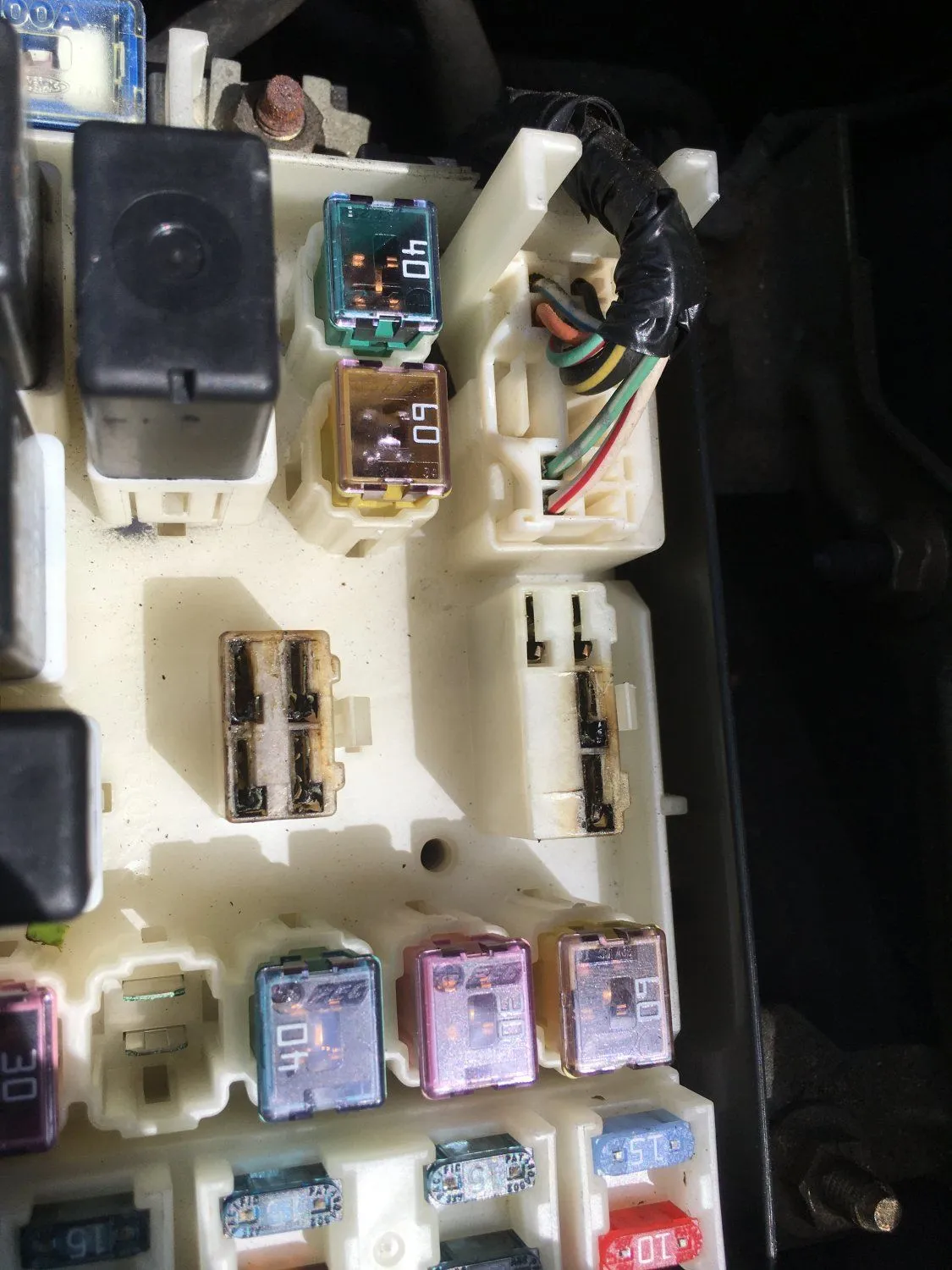

Check your engine fuse in the driver's side footwell.
If it's blown, your ECU shuts down and you get no spark.
I have done the timing referring to the workshop manual. The position of camshafts and crankshaft is like on the diagrams and the pictures that y’all provided. I haven’t checked the engine fuse, but I’ll make sure to do that ASAP. Also my relay ports are dirty (as shown in the picture below), is that normal?
Yes, that's normal.
There's a lot of power and heat running through the fuse box and they have been known to burn out and the fuse box needs to be replaced.
Dielectric grease helps to keep the contacts from corroding.

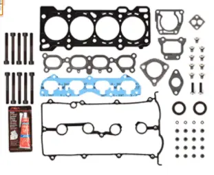

Do you think this kind of kit will do it?
That looks like a complete kit and should cover everything.
You may run into some problems and need more parts but that kit appears to have all the gaskets and bolts required.
