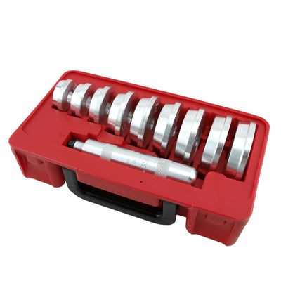

This looks like it will be a nice addition to the toolset as well: http://www.autozone.com/autozone/ac...Installer/_/N-264s?itemIdentifier=391360_0_0_

I like the post about using dedicated press sets instead of sockets. Definitly good advice. I've made a plywood shield for those times when I was sure pieces were one pump away from exploding.
