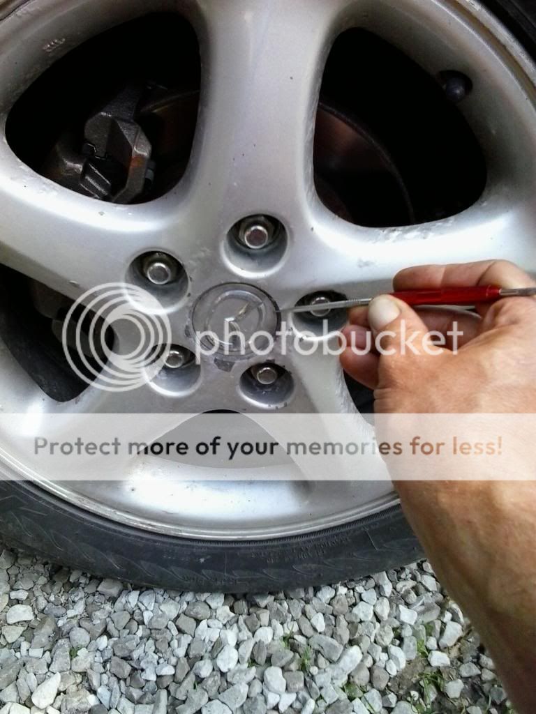

2. Removed the wheel and pushed out the center cap. This is to give acces for the axle nut using my breaker bar.
I just used a dental pick to pop out the center cap,... It saved me from removing the wheel then reinstalling it.
You can still use the punch to raise the divot on the axle nut with the wheel installed.
