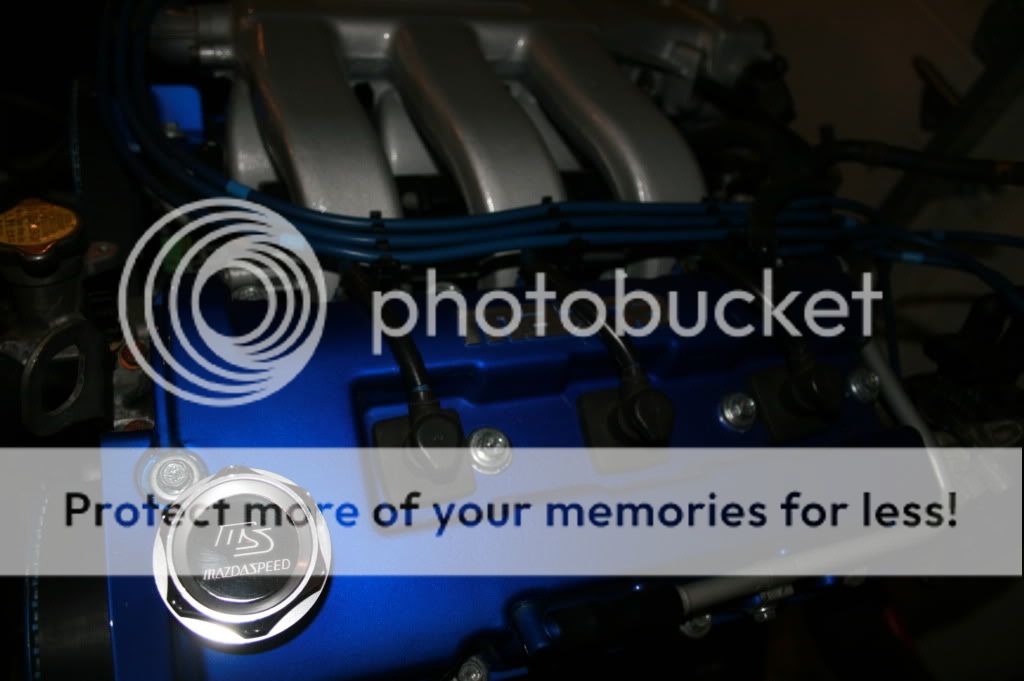

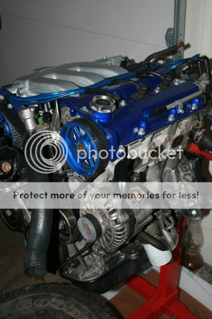

Got 'er all mounted up

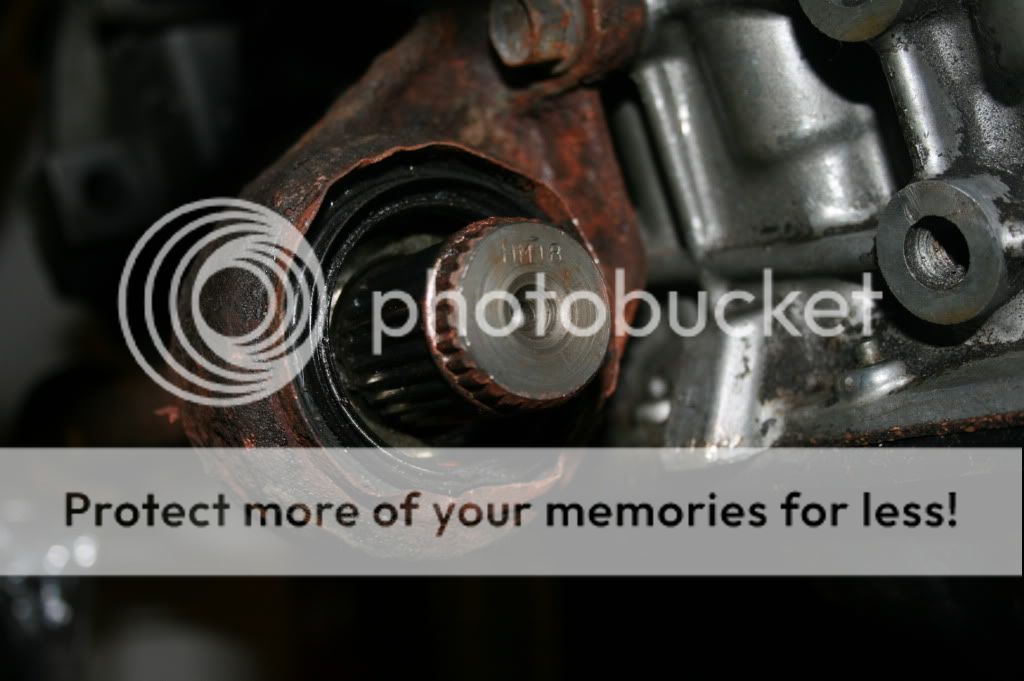

Hmm, intermediate housing got smashed a bit, probably from transporting the motor and setting it on things. I should be able to bend it back with a pair of pliers, or maybe that ring is part of the gasket that can be replaced. I think I actually replaced that on mine when I did my axle, now that I think about it. Are the 3 bolts the common or uncommon ones?
IIRC, the 3 bolts are the very uncommon ones. Keep that and cherish it. Haha. And you should be able to bend that flange back. That's the flange that Peaches whacked with the BFH on mine. Looks purty!
Do you have a estimated time for the swap?
Yup...that little lip around the bearing can be pulled away..
The 3 bolt flanges used to be cherished more than they are now, because people finally realized that you can drill a two bolt and they work just the same, lol.
That engine is CLEAN looking! I'm jelly..
