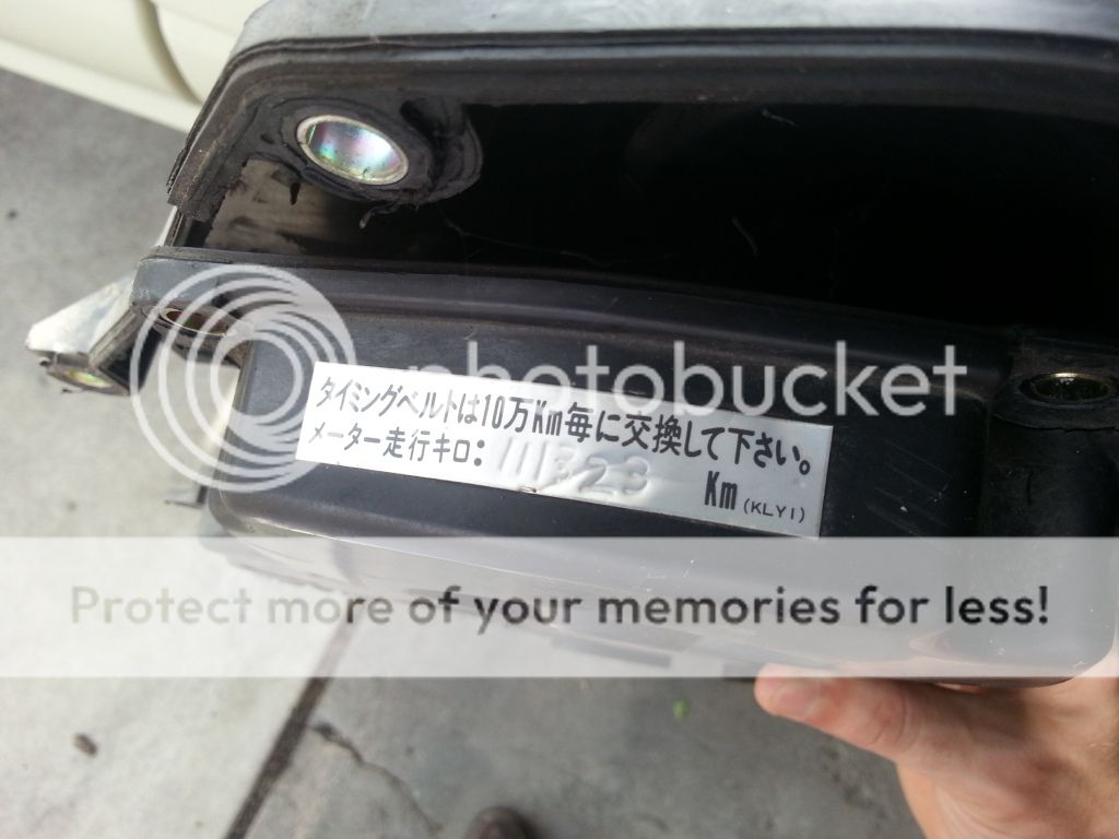

JDM timing covers (thanks Evan)

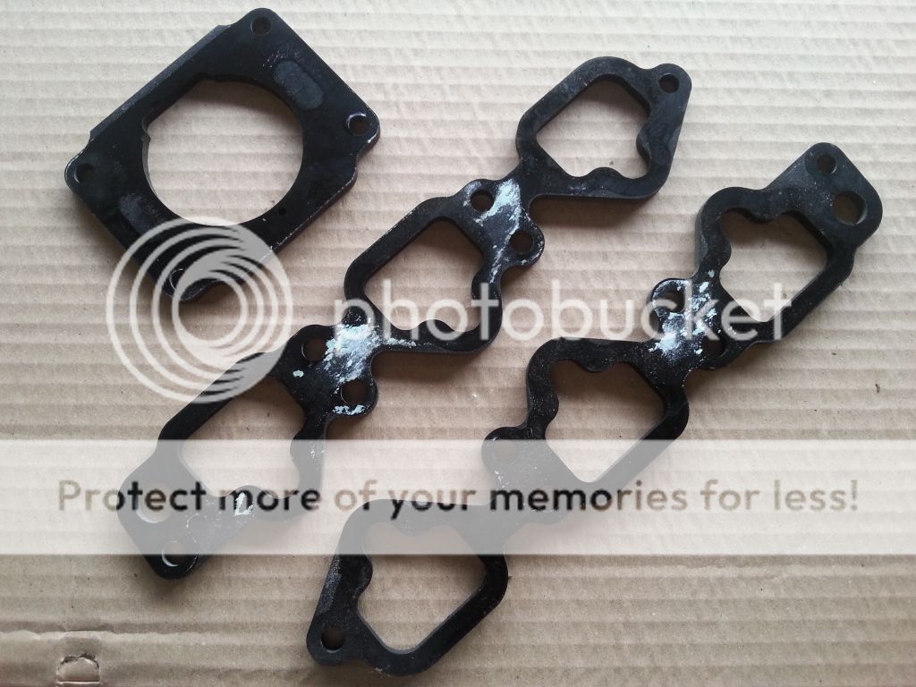

Phenolic spacers for the IM and TB.

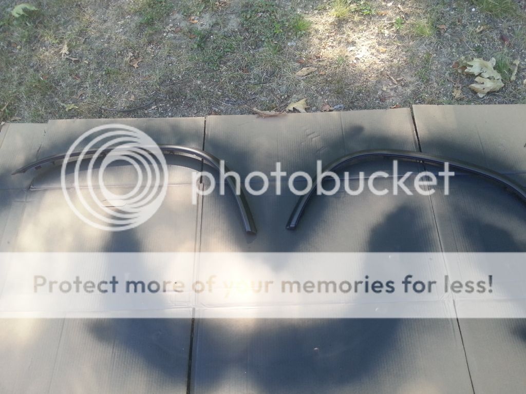

Some progress made on the multitude of projects. This one was actually put on hold for quite a while because of the weather. Whenever I'd remember, it was always too humid to paint, but not today!
I wanted to paint the fender guards for the Yota. Here's a pic of how they used to be, all chrome and yucky:
And now!

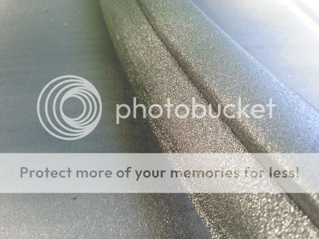

Close up of the in-the-can bed liner from Rustoleum

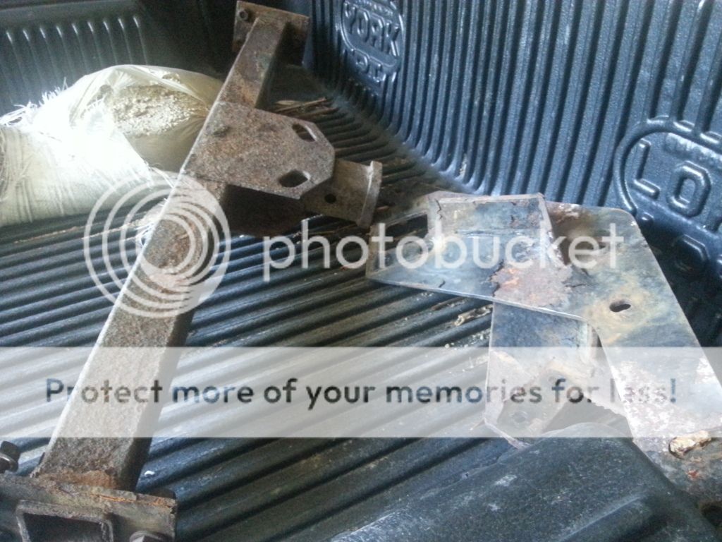

My mechanic got the hitch off with his torch. I don't have an oxy-acetalyne setup, so I felt okay having him to that! :biggrin: I plan to get another, this one was just too far gone with rust IMO

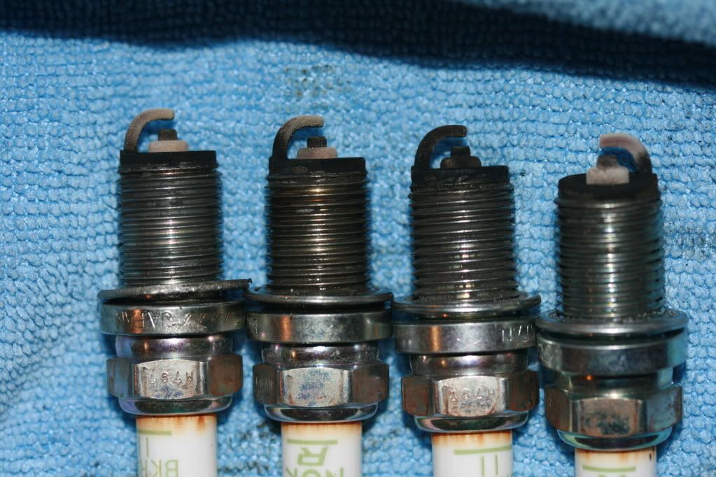

An issue I'd been having for quite a while was that under load (anything more than 40-50% throttle?) the engine just sounded downright terrible, like there was metal popcorn in there, or something. It sounded like something had already blown up and was crunching around. I didn't really put a whole lot of thought or concern into it since I was planning to ditch the FS anyway. I just got used to driving it more like a sane person.
Well, after filling up with 93, the noise seems to be gone. This has really left me scratching my head, as in no way should it require 93. First, the compression's only 9:1 or so, from memory, so that's not an issue. Second, when I started driving it, I put it through its paces, and I would really be surprised if there was a bit of carbon build up anywhere in it, haha. Third, I highly doubt that my minor bolt ons (cai, 4-2-1 Ebay Racing! header, 2.25" catback) leaned out the stock map enough to cause detonation due to it running hot.
This is how my plugs looks quite some time ago, maybe 1-2 years ago (I'm sure it was still making the noise back then as well, it has for so long I can't even remember when it started).
Now, this has left me to suspect that it's a ping/knock/pre-ignition of some sort, but I'm pretty puzzled as to what could be causing it. Maybe it will be time to play motor doctor and pull it apart after the swap!
