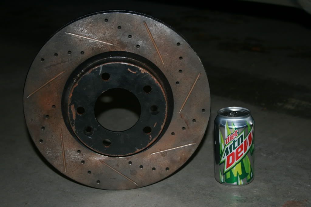

Holy rotor batman!
Did you get it cleaned up yet? hahaha
Let me know about that lock. If a few shots of spray doesn't work, I can (or tell you how to) pull the lock cylinder out and we can let the whole thing sit submerged in penetrating fluid. Get in there nice and DEEP like!
06 Mazda 6, they're StopTech, from what Evan's told me. They have a bit of flash rust, but I can still see the cross hatching on them, so I'm 99% sure they're brand new! New calipers, as well, and they're apart and ready for powder coating. He threw in his Mazda 6 rears that were from the junkyard as cores, so I need to trade those in for remans, get rotors for the rear and pads all around, plus some SS lines, and high temp fluid and I'll be all set to slam my face into the steering wheel when I jab the middle pedal!
