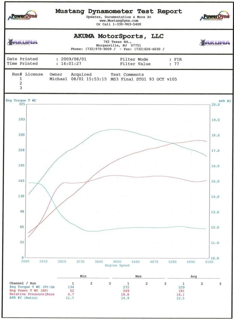

I gotta say, that looks like a very safe torque curve:
155 lb-ft @ 2500 rpms
165 lb-ft @ 2750 rpms
210 lb-ft @ 3000 rpms
245 lb-ft @ 3500 rpms
315 lb-ft @ 4450 rpms
I'ld love to see that kinda stuff reproduced with AP or Standback.
heres mine, its on a mustang, max torque was pushed out to 4k or so.
my dynojet readouts are in my sig....roughly the same shaped curve

500, but i get cheaper reflashes as i plunge deeper into this moneypit i call a car. o yea im tuned for 18psi, just didnt have enough resistance to hit it on the dynojet. maybe im cresting 300, but who knows. i know brian put down 290 on akumas mustang and it came out to 355 on a dynojet, then he put down 305 on akumas mustang and hit 380 on a dynojet as well.
Akuma's dyno is a real heartbreaker. stock ms3s have trouble getting over 200.
Dynojets are easy to gain hp, no real resistance. The dynopack is a nice middle between the mustang and the dynojet.

and i believe the order of hp goes:
highest
dynapak
dynojet
dyno dynamics
mustang
lowest
dynapack is good because its the most consistant, mustang gives the most accurate "real world" hp. either way a dyno is just a tool to see hp gains, not bragging rights. unless your a ricer (ricer)
Yeah the roller dynos are sometimes tricky to tune on. I love our dynapacks because I can just set the car at one rpm and load and try different things without having to run thru the whole pull.
BTW, as a general rule, the dynapack will be about 15% less than a speced dynojet, and 8-10% less than a mustang
no arguing, just discussing
it is impossible to compare numbers from one dyno to another. variables com into play not only with the car, but how the dyno has been calibrated. I know Akumas has to be one of the lowest dynos out there, and the disparity only increases with power.
akuma/dynojet
249/286
291/355
305/380
(owners sti)
540/670
(a recently tuned gtr)
612/785
Dyno is a dyno, the only thing is dont compare between different dynos and as well, like in my case dyno on the same dyno, make the change, dyno again. I mean that way you can see a difference as everything was the same other then the flash. Keep as any variables constant, the more reliable the data I suppose.
You are very correct! Can't tell you how many times I have told customers that very thing! It is not the numbers you get, its the delta between before and after that counts!
agreed! also area under the curve. i could care less if you make 1000whp at 1 point, and crap everywhere else, give me 350whp from 3-7k and ill be happy (for now)
EDIT: yes starscream you are correct, its good for before/afters for THAT DAY only. go there when its cooler/hotter and your numbers will be different. its only a tool to measure changes in power in a before/after scenario
