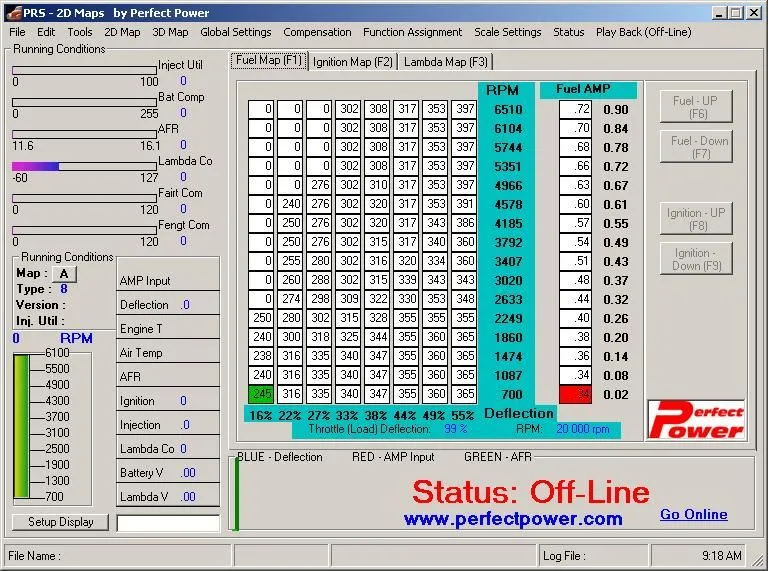

Well, I tried to get it working with DOS last night, with no luck. When I connected it up, and fired up the DOS software, I would get a comm error. I then proceded to do the LF FIRST command, and the values would show up in the software. After that, I had no control of my software. I just about believe I have a fubar unit. :'(
Patrick, give me a call about the unit. 732-222-3679
Ok, I just had an interesting break-thru! I was able to successfully load the DOS software up using a Desktop computer at here work. I used a 12 volt power supply (4-6 AMP) that I just bought from Fry's to power the unit. I accually see values changing. Now that I have a file loaded successfully, I will attempt the Window software connect. Fingers crossed folks! (yippy)
Ok, I was successful in getting the PRS8 communicating with the Windows software. :D Looking at the menu, it looks like I have hardware version 36.
This is what the running conditions said:
Type: 8
Version: 36
Inj. Util.: 0
I wonder if this version will work with my ignition system?
Type: 8
Version: 36
Inj. Util.: 0
That is great news Patrick. Now dump the DOS program, it sucks. The windows program works much better. Your ME Windows will work fine for you. We have been working on a Mazda/PRS piggyback for a while now.
I will send you all of the info you need to get it going over the weekend. Wait untill you start tuning the unit. It does more then most aftermarket system out there. The cost is also well under what most systems are.
Thanks again
Later........Nick
