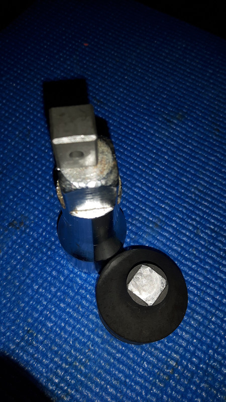

It's only a 1/2" drive socket so I had to use my breaker bar. It wasn't working so I put a 4' pipe on it and the breaker bar was bending and about ready to explode, so I decided to go buy a 3/4"- 1/2" downsizer adapter so I could use my 3/4" drive ratchet handle.
That worked for about ten seconds and I twisted the 1/2" square right off the adapter.
I took the adapter back for a refund but they only have a replacement policy so I got a new one.
Then I asked the guy in the service department for help and he came out with a 1/2" breaker bar then got a pipe to extend it and then said "Nope" and asked me if I have a grinder.
He also said that as soon as the bearing is over torqued it's wrecked.
So I went back home and ordered this.
So we'll see what happens when it arrives.
I'm going to go bang my head against the wall for a while now. lol

I was pushing down with all my weight at almost 4 feet from the nut with an extender bar.
I've probably got over 600 ft/lbs of torque on it.
Duhhh.

Son Of A b****!!
And, .. I have no idea why the hell I didn't buy a 3/4" drive socket instead of a 1/2" drive??
Wow... I feel really stupid right now.

Son Of A b****!!
I Remember Now!!
It's because the 1/2" drive socket was $8.99 and the 3/4" drive was $27, so I thought I'd save some money and go with the 1/2" and save a bunch of money!!
That decision cost me ~$70.

The 3/4" doesn't look that much bigger than the1/2" but it's got more than two times the cross-section and more than three times the volume.
